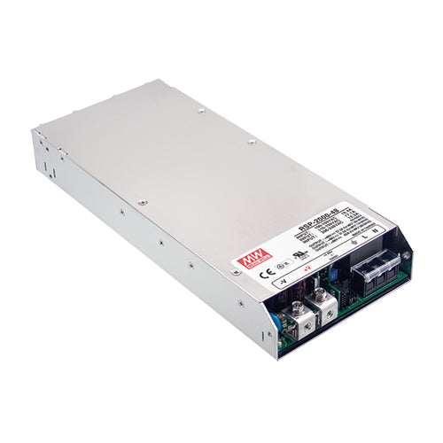

                            There are the 24 volt Meanwell's but still only 63 amps.
                            Very powerful power supply provides 1500 watts, 62 amps, 24 volts, with active power factor correction
                            I use two of the 42 amp versions for my PL8's.

                              Howard and Larry, the Mean Well RSP-1500-24 is one of the best power supplies and is available with 120V input. Pescador has a link to Progressive RC’s site.
