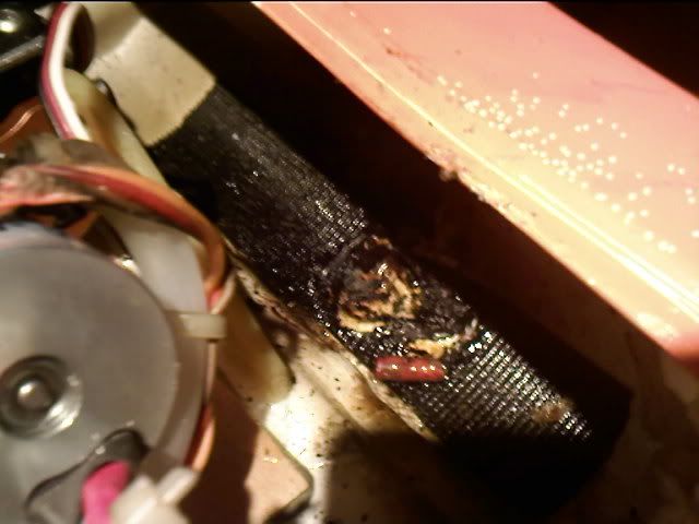

          well today was my first test run and it did not turn out well.... i ran the boat for about 5 seconds and it hopped right up on plane but shortly after it flipped. at which point water proceded to get into the hull. my esc shorted out and fried which left a giant bubble in the hull that i think may not be repairable ill post pictures in a little while, i have to go research a new hull this time self righting

            That sucks man. I had the same problems with my Sidewinder esc. So much for waterproof. Did you tape the hatch? Also, if your looking for a new hull, the eco hulls are self righting.
              Lets see the pics, it may be repairable..

                i taped the hatch really good ( or so i thought ) i think im gonna go with a seaking esc, i was looking at the mhz gecko because i saw a vid on youtube of it righting itself
                im not really a fan of the eco hulls but idk

                            here`s the pics
                            -James

                              Sorry to see that happen, and only 5 seconds into your first run. that is repairable. I would just shave off the bubble and fill it back in with epoxy.

                                Better to stick with CA , Epoxy will not hold on the Styrene.
                                Sorry to see the melt down.
