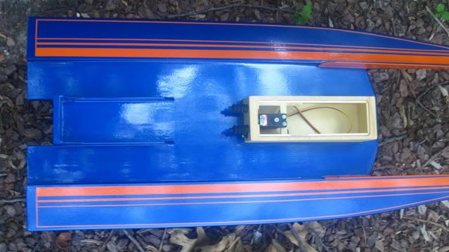

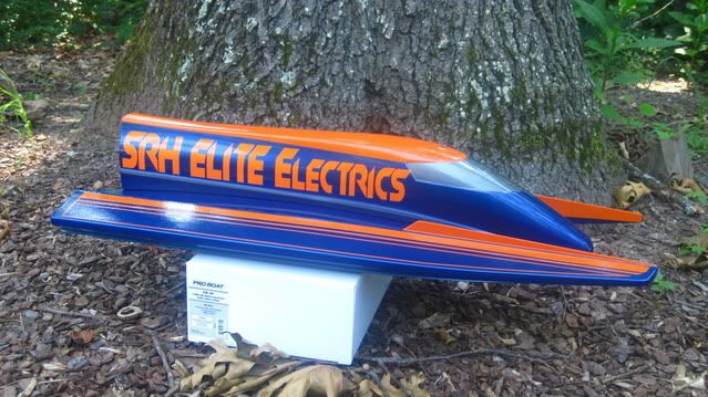

                • nate
                  • 1652
                  #23

                  • sailr
                    • Nov 2007
                    • 6924
                    #24
                    Herb has used K&B lower units, OS lower units, IRWIN/REK units, etc. Doesn't really seem to matter just so you get the motor hooked up to the prop?
                    I'm kinda partial to the angle drive just cause it's more techie lookin to me. If you want to save some bucks, you could use Fullers setup at only $90 includes shaft and motor adapter I believe. You would want to verify that. Those lower units work just fine. Herb uses them.
