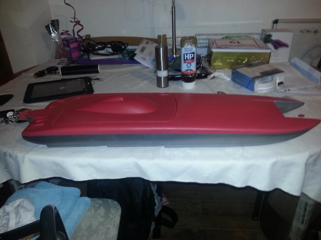

              Not as pretty as some of the work on here but it's a first attempt so I apologise

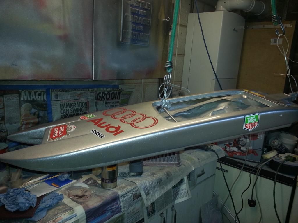

                repainted after issues with reactions it's come out better than ever thought
