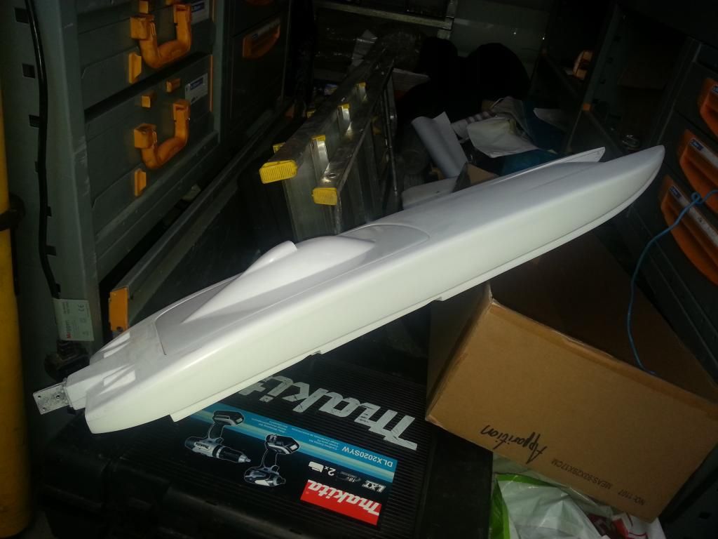

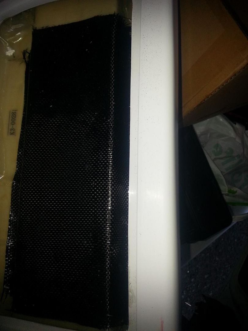

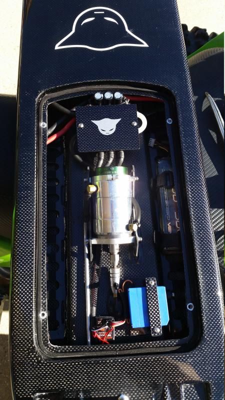

I've just bought the above and have a slight issue I need help with. I plan to run a single 1900kv motor on 4 or 5s. The problem I have is the transom. It's not flat. It has 1.5x1" rectangle in the middle that sticks out about half an inch. How do bolt the strut assembly to it. There seems to be no room
32" apparition cat help
This is the hull I have, cheers for any build advice you can offer -
Most folks run twin motors on this and only the rudder is mounted on the center section. This being said there are rudder strut combos that have an offset rudder. You will have to look for one that will mount to the transom given those dimensions.IMPBA 20481S D-12Comment

And here's the strut assy you need..this is what I use on my builds. FYI rivercat = apparition
http://www.offshoreelectrics.com/pro...prod=ose-8097832" carbon rivercat single 4s 102mph, 27” mini Rivercat 92mph, kbb34 91mph, jessej micro cat(too fast) wasComment
