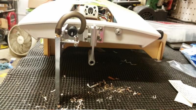

    Starting out.....mounting hardware. This was actually a set back type strut mount but I cut it down to fit. It's what I had. Out of my pocket I think i have $30 in this boat lol. It's gonna be something fun for my son to knock around with....

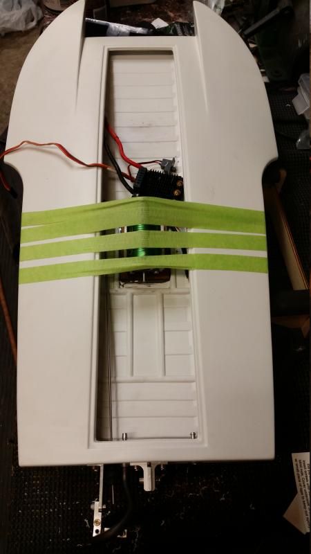

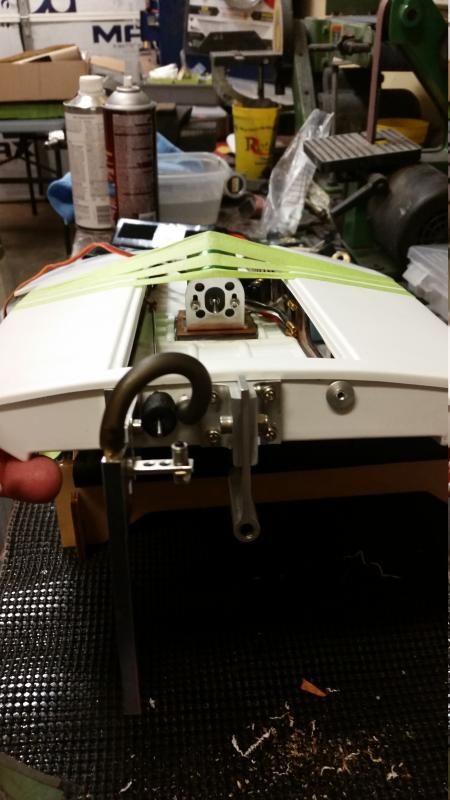

            How do you guys hold the hatch on? Please don't say tape.....lol

              the front hold down is 2 pieces of plastistrut angle epoxied together.
              the back 2 are 6-32 aluminum parts I got at the hardware store.
              not a lot of room for a esc in this hull. the AQ 60 fits great.
                Use tape, and save that epoxy you're using to waterproof receivers for building boats.
