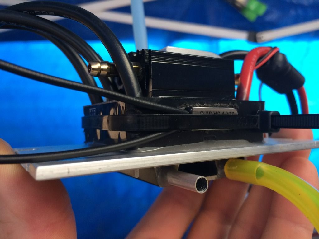

        Installed the thermal sencer . Dremeled down to the special copper compound core for the best heat reading I can get. Notched the 4 corners of the esc's plastic lower to hold the zip tie in place wich holds the switch in place. I will ad some thermal grease between the switch and core later on.

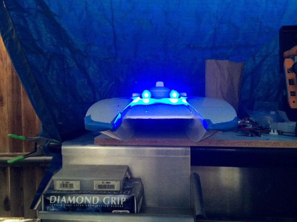

          The lights are going here. They are blue.

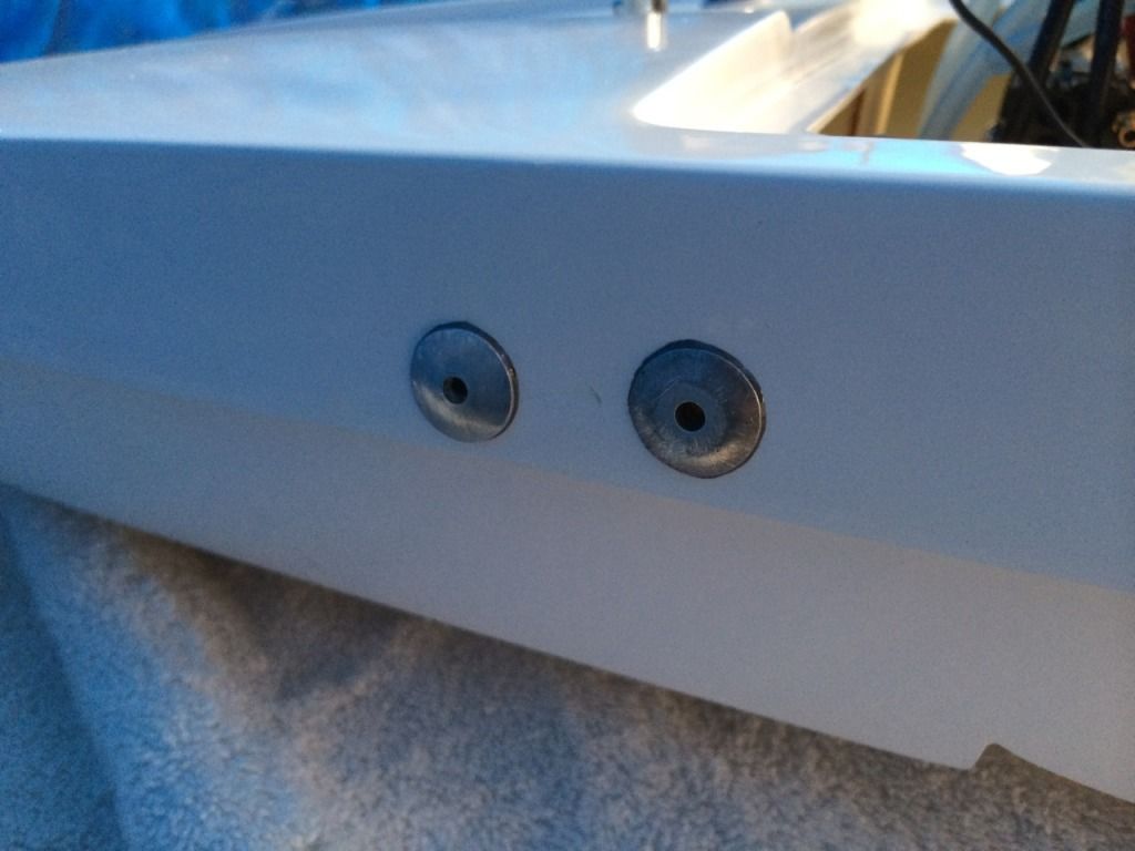

                Rubber mounted the lights with nylon washers. Bought a couple 3/16" rivets for the water outlets. Turned on the lights and they are pretty intense ! Very confident I will see them during the day !
