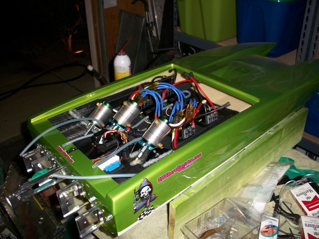

    Some people have said in line with the props & others (another forum) have said behind the props. So I've made them with the leading edge about 1" behind the trailing edge of the props with the intention of shortening the brackets & moving them forward should it be considered that any turning issues require them further forward.
    It certainly will be running oval, but also a larger triangle 'Offshore' track too. So yeah, I figured two props turning anticlockwise would help with the cornering.

      Oh! Wow! Man.
      4 drives. Magic.
      And turns well with one rudder you say.
      That is heartening.
      Any videos of it running? Just gotta see that.

        Here is a couple .
        4x CC 1515's
        Unfinished 447's L&R's
        .150 cable's
        4s 4p
        Aeromarine Conquest, 0-63mph in 2 seconds.

              randy , you seen it on 6s 2p with the motors pulling no more than 100 amps..... Not enough battery in the boat ! Remember lol

                              It was really amazing to run on 6s 4p.... If you squeezed the throttle all the way really fast from 50 mph it would literally instantly take flight . Nice and easy squeezing when poking around on 6s !
