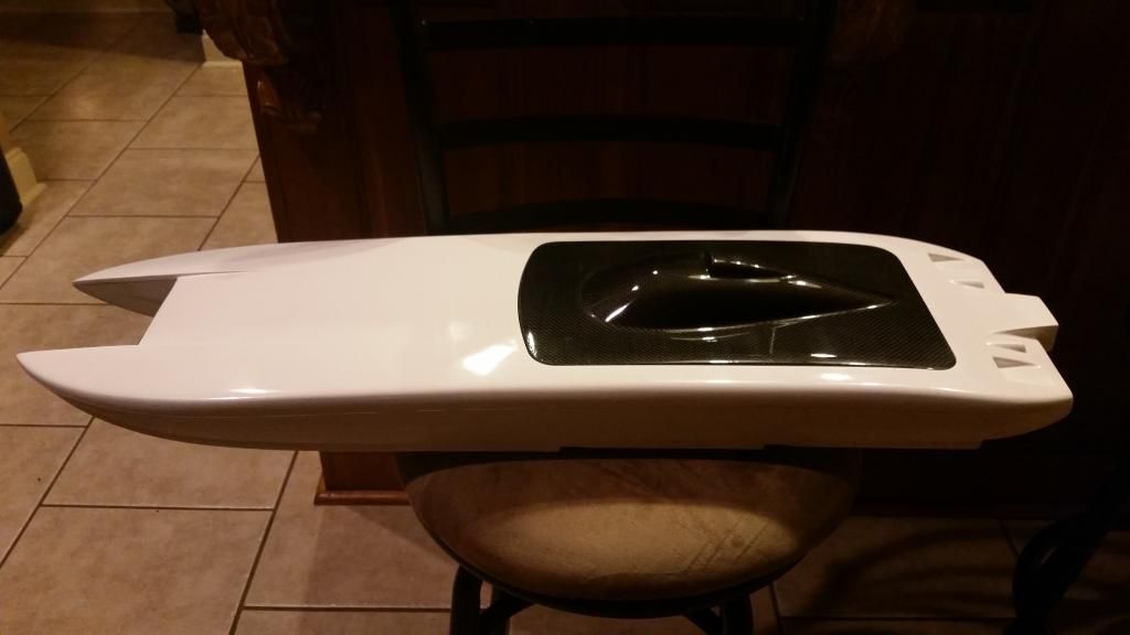

              This may give you an idea. The fg hull is going to be painted a bright orange and have a carbon top. Visa Versa for the carbon boat.

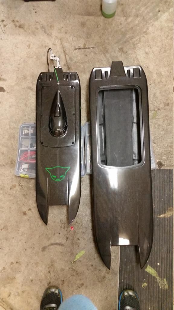

                    I run a t180 in it. I had a early model swordfish 200 in it that was used when I got it, it lasted exactly 1 battery pack before it smoked. I think it had something wrong with it when I got it though. Here is a pic next to my fantasm
                      #25
                      Here's my rivercat next to my fantasm

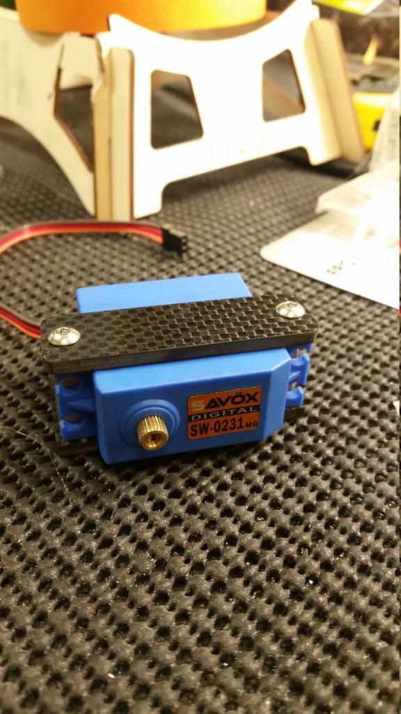

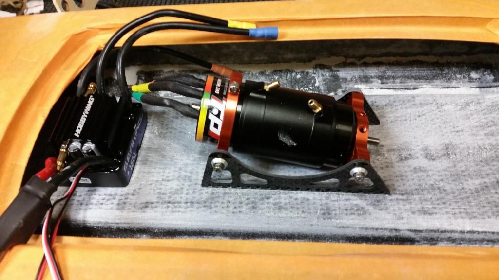

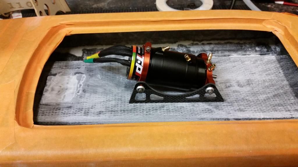

                        Update. Got pretty much all the parts in for the carbon build. Tp motor, v3 hobbywing esc, harware, savox servo, two flex shafts (he wanted a spare) decals, carbon battery trays. Now it's time to get busy. I started sanding the inside of the hull but it's been so hot the past few days I haven't finished sanding yet. Inlay will be done in the next day or so. In the mean time, wanted to see what the motor and esc looked like in it....

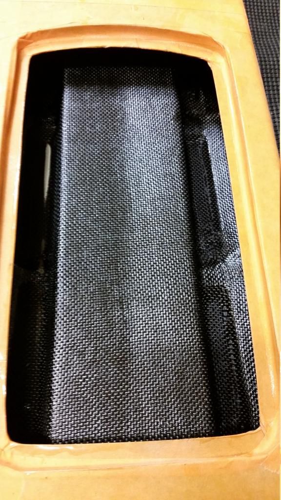

                          Got the inlay done. Epoxy in tips, tunnel and transom. Had some pin holes in the joining seam....luckily I reinforced it along the seam. We would have been letting water in. Got the servo mount built too.

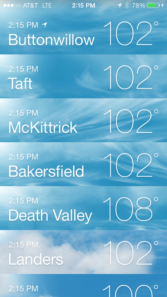

                            I've been hearing you say it's too hot a lot ! I'm in Bako , it will be 108 at my house when I get home lol
                            --Albert Einstein
                              #29
                              LOL....if youve ever been to louisiana youd know that 95 feels like 115 because of the humidity! nasty!
