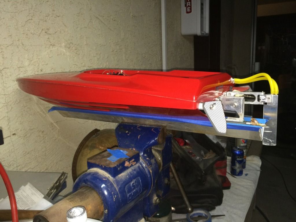

      Getting ready to build a proper ride plate. The one I was testing was actually horribly aligned ! I'm going to make sure it's perfect this go around. Should be way better than my eyeballed version lol

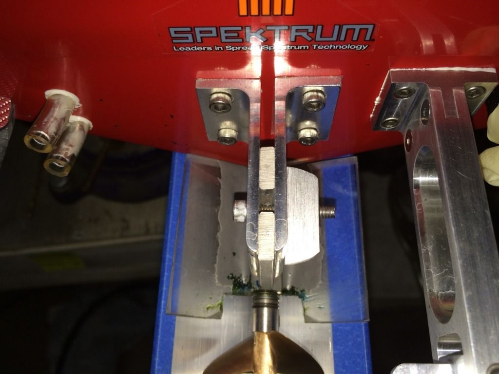

        Let's hop there is not a earth quake while the tack cures.... This plate is a bit longer with trim tab steps to see what happens. The prop is much closer to the plate, hoping for more water to the blade , I was thinking it was actually pushing it away from the blade on the last one. This ride plate has a wider left side thinking it would do something too

          Ok so I got tired of dicking around with the lexan and made an aluminum plate with the new speedmaster strut . The kicker is they don't make the struts like they use to and you can bend them easier . Not good for my app.

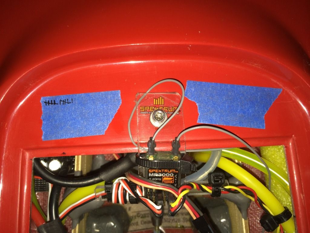

            Just ran it and it seems promising . I like how I can bend the back tips like trim tabs. I have 11 runs on this boat now and the setup is a perfect match so far. The esc and motor are running way below dangerous temps. The only thing getting warm are the CC 6.5 bullets on the batt side but those are only around 120-130 after 3.4-4 min runs. The x642 is causing more power consumption but only marginal increase in esc and motor temps. Batts running a little warmer but not hot. I need to sand the bottom plate some just to true it up some as it was rocking but not as bad as the first plate which was un even as well . Bending the tab on the left side of the plate helped. I had to come up with a system to keep track of my runs..... Maybe I will use the tape on the right for crashes , ok sounds good, it's 3 . I uploaded the pic before I thought of that lol

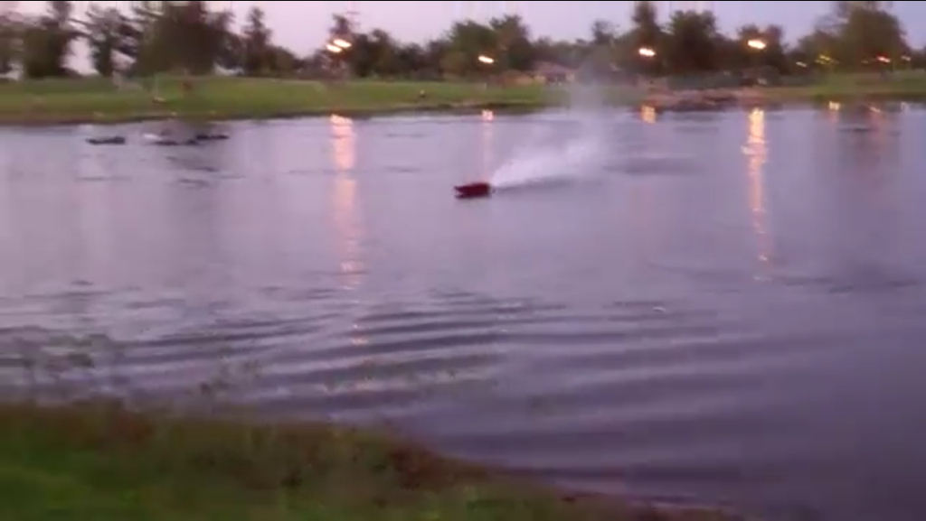

                  Thanks srislash , ok hear is my newest vid . It's my second run of the day, the first run was good and only needed some positive taken out of the right plate tab. This vid is called "getting skippy" lol
                  I hit a fish or something soft because there is no rudder damage. It happened just after the first lap.

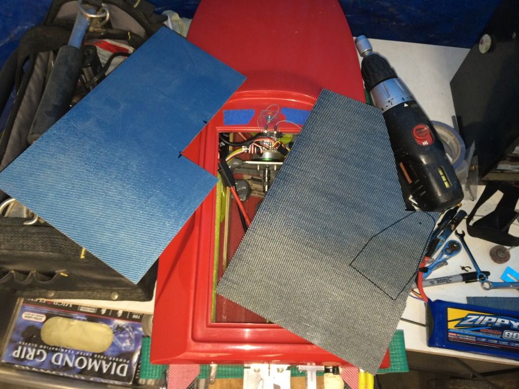

                          Now quick question for everyone .Blue or Titanium CF tray ? The Lexan is just too flexy and when I was pulling out the batt the lower tray flexed out of the front holders from Velcro's forces. Now I'm done with lexan and I'm thinking it could play a minor roll in handling because of possible batt movement due to the spongy securement. CF should also double my boats value

                            The lexan tray would be much better if glassed or epoxied it in but since I need it removable the cf will be better . Hit me up if anyone is interested in owning it.
