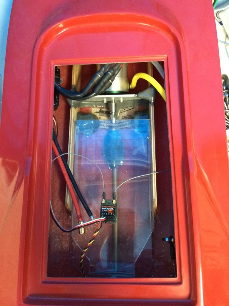

    Plumbing for the motor on the right and esc on left.

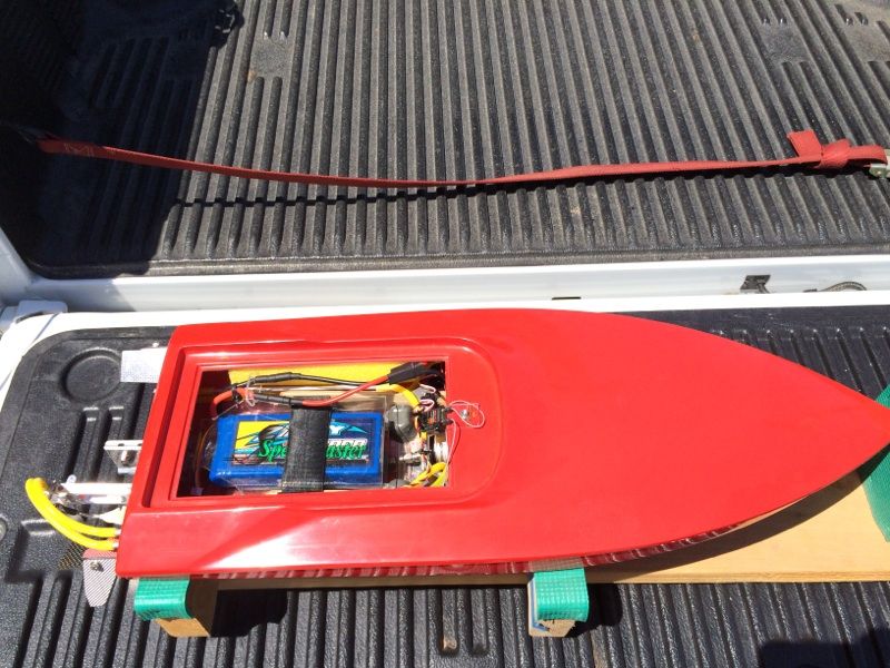

            So I got a full pool noodle in and the plumbing done. I want to build a bracket for my receiver to put it in this area. I would like some input if this is going to interfere with the signal ? , thanks.

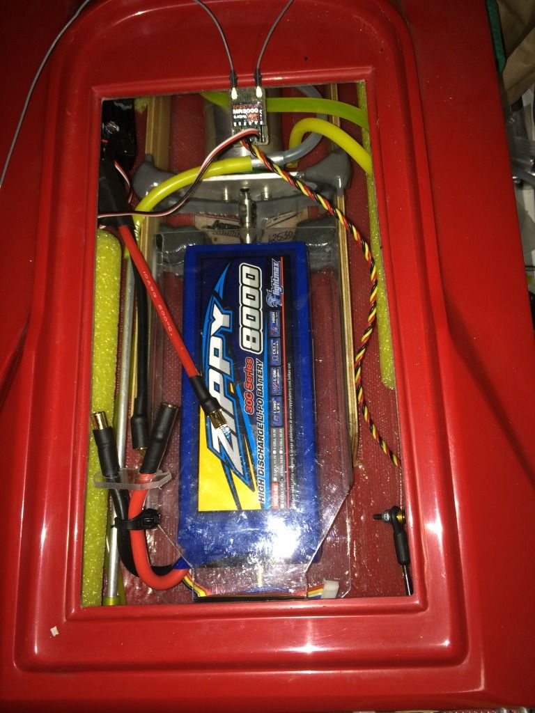

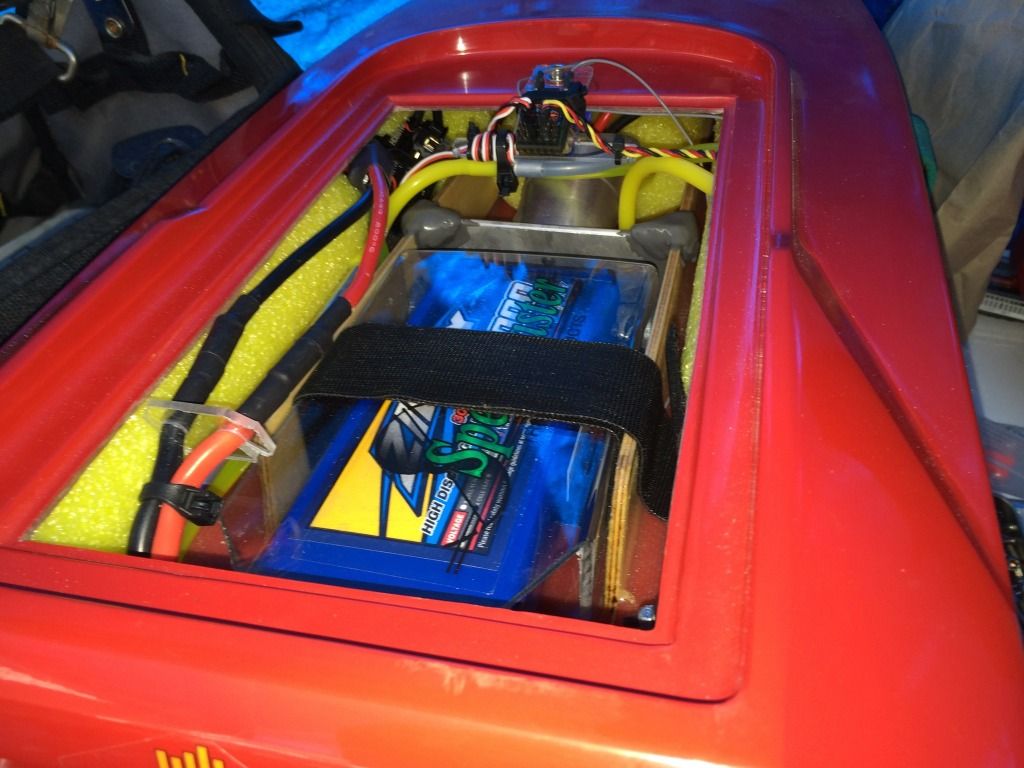

              So this is what I came up with. A reciever mount that tighty things up and keeps it all out of the way. The Velcro wrap seems to be perfect. I have 2" Velcro holding the batt to the tray as well

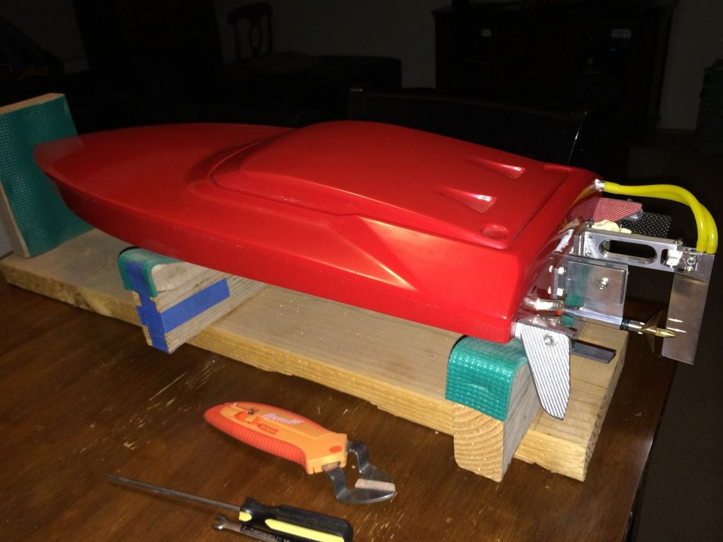

                Here is a final pic of the transom before the maiden . I kind of like it let's see what it will do and if it turns out to handle as intended to

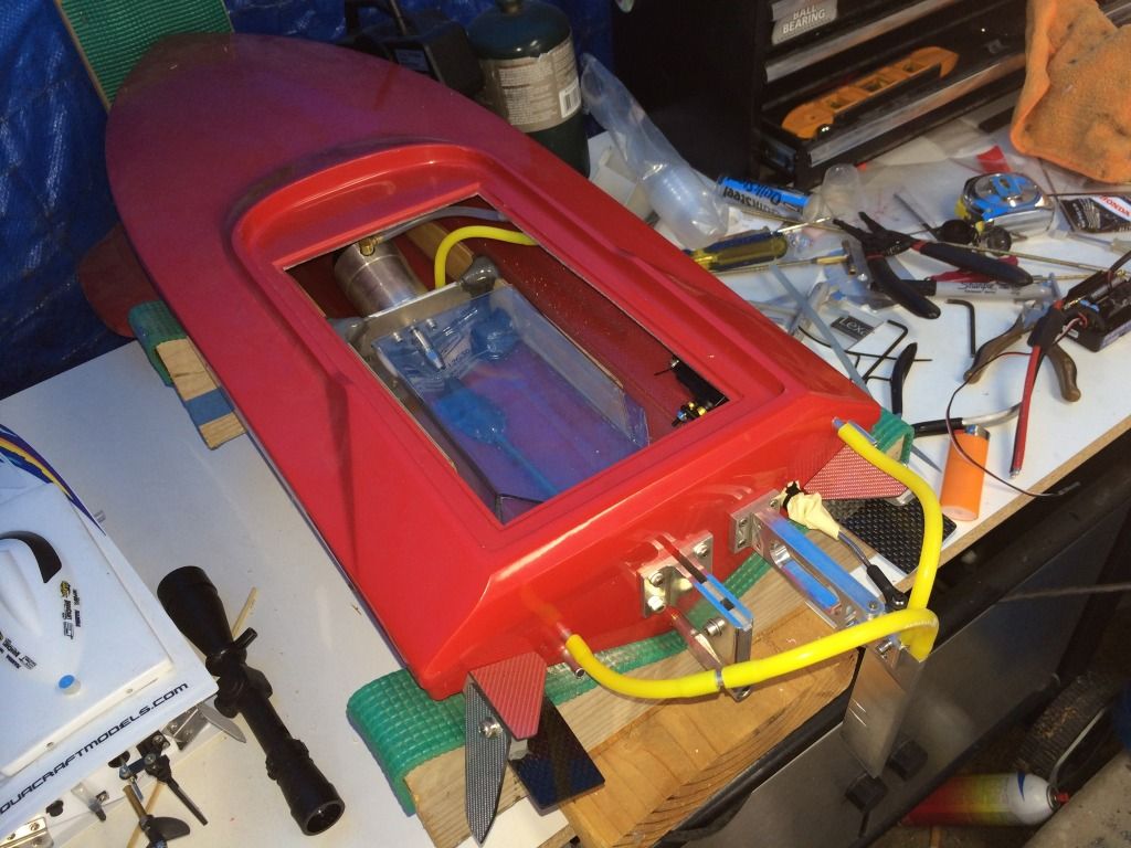

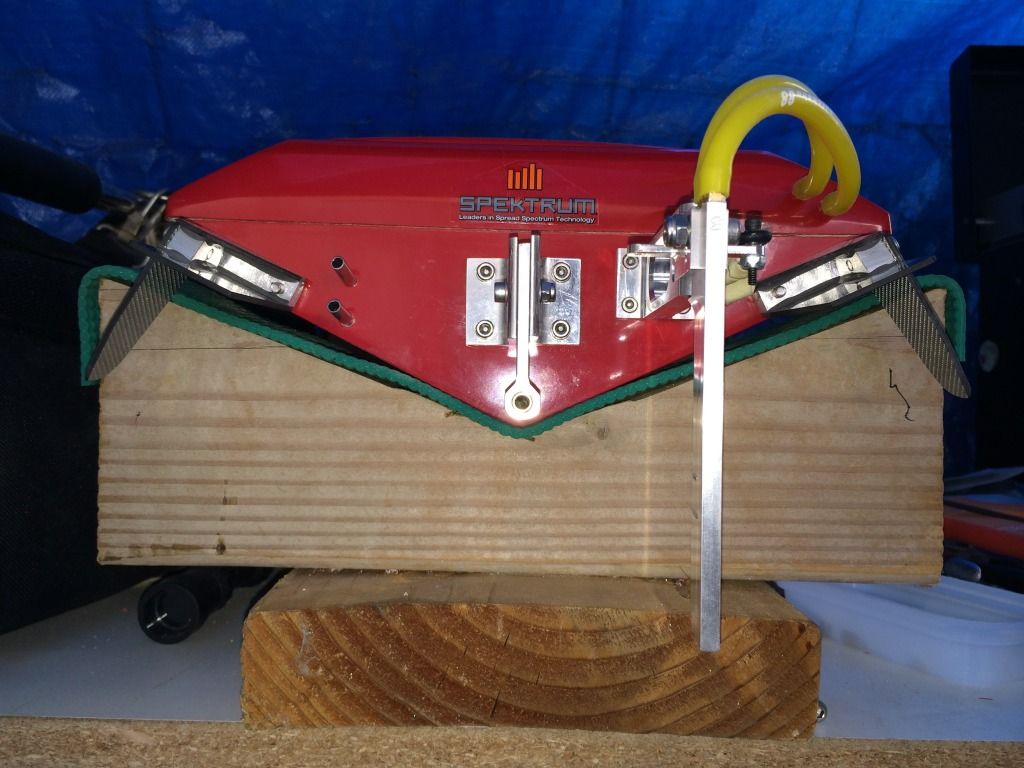

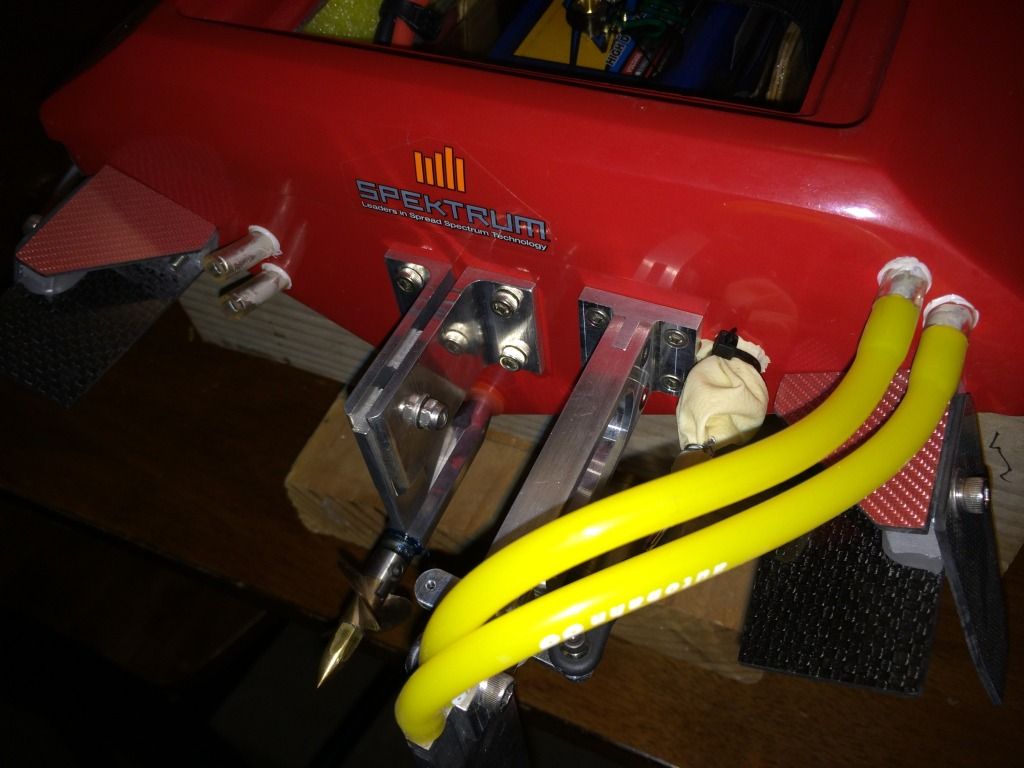

                    So I ended up going cheep-o on the water line in and outs but there is a up side ! Saved money and I don't have to deal with the side exhaust spigots inside the hull taking up my precious hand space and noodle room ! I made some small seals with some Moto fuel line and Honda Bond , totally removable and simple. I can still ad positive or negative on the strut and made a silicone ring seal to keep the water of the wood inside the transom . Up next is a float test and hopefully a maiden run .
                    --Albert Einstein
