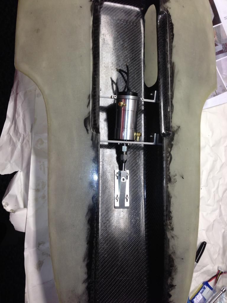

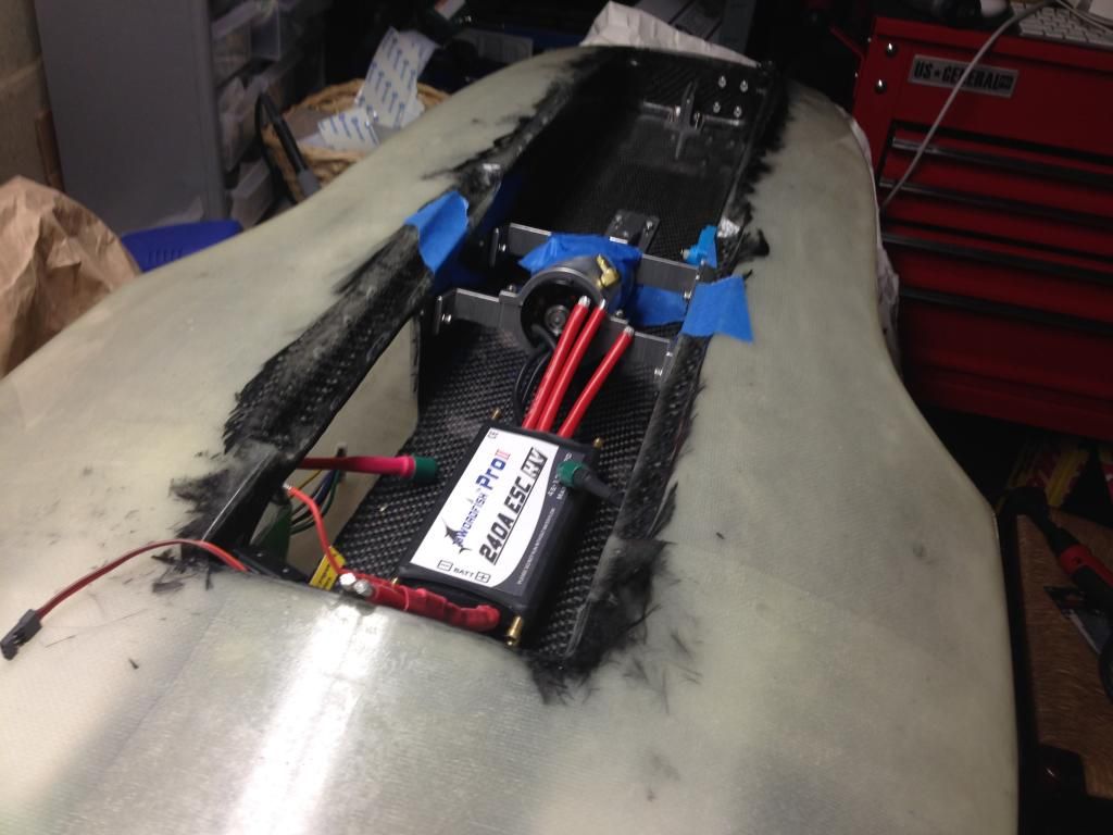

    Some more progress - the holes in the tunnel worked great. I'm going to mount the ESC with a velcro strap to make the batteries easier to change. I was going to mount the batteries on some carbon trays, but its going to be tight so I think I'm going to stick with the velcro and pool noodles as suggested. I made the servo and engine mount plates out of some aluminum - must have been too hard as I've been through (4) 6-32 taps in this project! (tried various oils including 3in1, stihl bar oil and even lard (tip an old timer gave me).

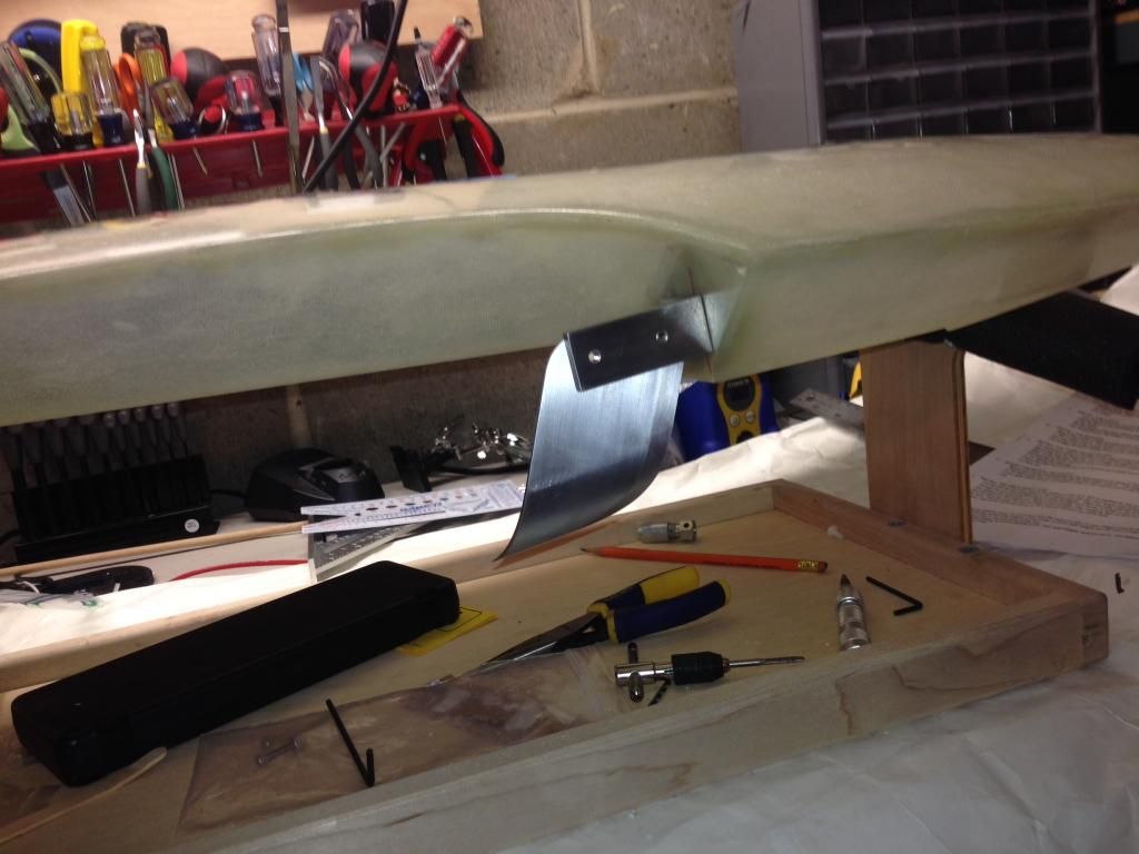

        Thinking of adding a tail fin - anybody have a suggested method- 1/4" ply glassed in? Tabs in the bottom of the fin?
