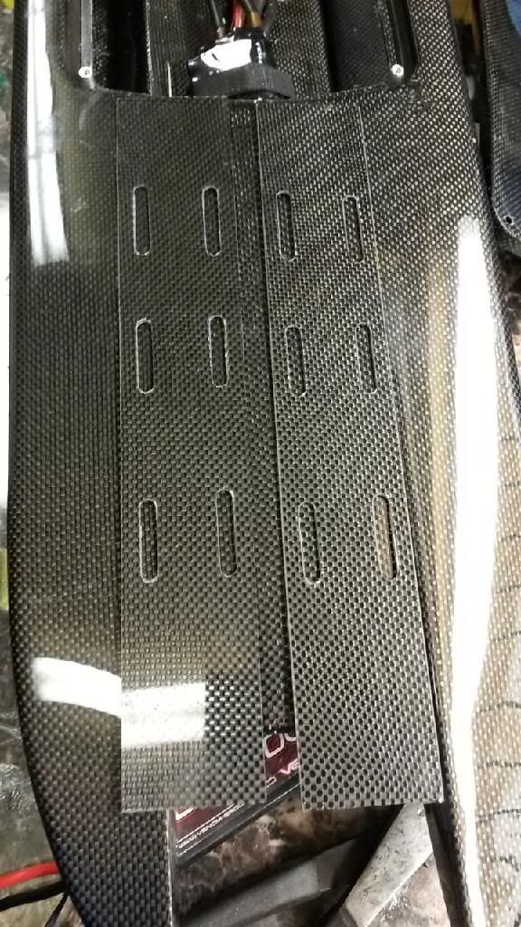

            He's answering your question in general. Here's my trays I made the other night out of carbon fiber

                Originally posted by MARKBRENNAN
                What can i use to build to make battery trays
                I would ask how big are the batteries first. Weight is a factor. The bigger the battery, the stronger they need to be. Cost is another factor. You can pick up some cheap wood material from your local HS. Or you can spend $20 or more on some carbon fiber sheeting and make something bulletproof! Wood won't hold down a 10s lipo after a crash at say 40mph or more. I use 10s2p and use CF hold downs with 4 HD straps. The hold down are anchored in with SS 30mm hex head screws that screw into an anchor nut epoxied into the bottom of the hull.
