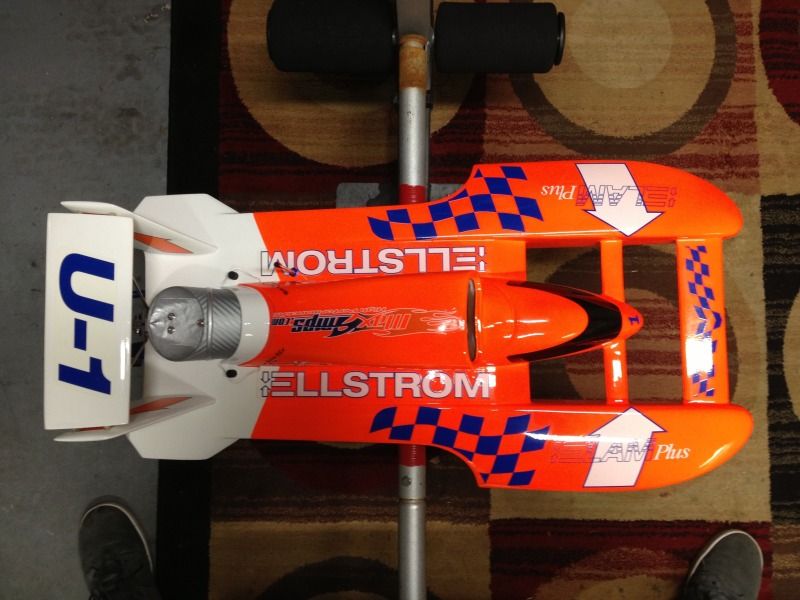

            Well after too much work on this prop, it's done. Man that titanium is hard whew!
            I'll get out tomorrow for a run and report on this prop. It got me 50 on my stock ul1

                  #173
                  I got it out for a quick test run while I was running some errands with the wife today. I put 8oz of 3/8" rod coupling's. 3 couplings on each side shoved to the front with bubble wrap. I'm thinking that I will take the couplings out for the next test run tho. I'm thinking since I used such thick epoxy that the extra 8oz's is too much. I know it'll move the CG back but I want to try it anyway. And I definently need a better turn fin. This thing don't turn for crap, I had to dodge alot of lily's so I couldn't really get a long straight run. In the video you can tell she weighs too much but I was just happy to get it wet. I plan on trying an x642 prop next time out. Next run will be more dedicated and Ill put it through a full pack or two. Any advice is greatly appreciated...

                            #178
                            No weight in the front! Decided to go with a p220 prop, and rounded off bottom corner of the strut mount. Ul1 2mm black fin. She wieghs exactly 6 lb.'s. Feeling way better with this run.
