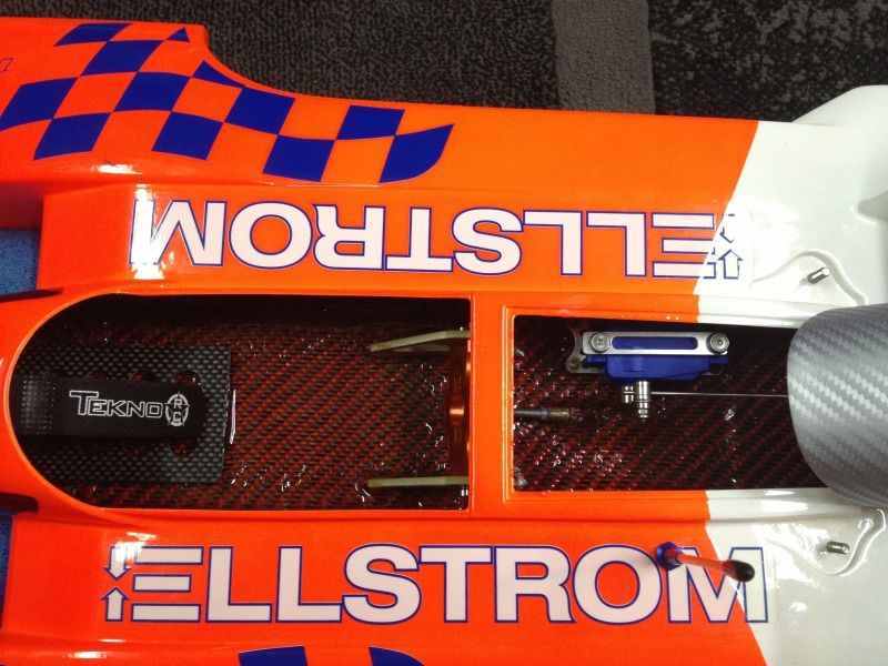

            Just wanted to show off a little of my progress. Hope you don't mind... This is my first build and this thread has helped me alot. Thanks Heaving!

              Lookin good! Can we see the inside?
              Looks like you got the silver carbon vinyl

                Thanks! Yes I went with silver CF. :) I haven't done much to the inside except the demo. I got some carbon Kevlar to lay down, but I'm dreading laying it down. Afraid I will mess it up. Lol, thinking about leaving the floor board stock and see how it goes. If I do lay it down, ill probably just go down the center tunnel area instead of the whole boat...
                I did hack into the bottom like you did. Reinforce the transom, and filled in with a piece of graphite. I left the stock tube in, and just extended it. I'm waiting on a few things including the motor mount to arrive.

                      Overall I am okay with the Kevlar inlay. It came out absolutely terrible compared to what I see on here and your inlay you did. I did not use the right epoxy, I just used some cheap loc tite epoxy I already had. To be honest I could of done more research and practiced but I got a niche one late night and just winged it. In the end I am pleased with it because it stiffened up the hull so good, and I guess it looks ok. Next time I'm sure I will do better hopefully. I'll post a pic when I get the combo installed.

                                #165
                                Sweet man yours looks good too. Thanks for the pics. The prop you see in my pic is a Prather 215. 40ish mph is about what I figured and fast enough for me with it. I'm not looking for super speed. I was going to start out at 12 oz of weight but you might be right about starting at 8oz. After I get a run or 2 in I think I will put in a new stuffing tube so it'll be nice and solid. I ordered a cheap lipo today so just waiting to receive it and finish up. Ill post up my results for sure.
