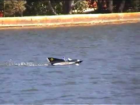

            I like the idea of the batboat,
            Hears a video of one for you.
            Just may be a little hard to see, Being black that is in the water.
            You could add some red and bright chrome for the windshield like the old bat boat was.
            Also you may want to add a support under the back of the motor,
            I think it is longer the the stock 1800kv motor and would add more torque at the motor mount.
            Just looking out side the box at it.
