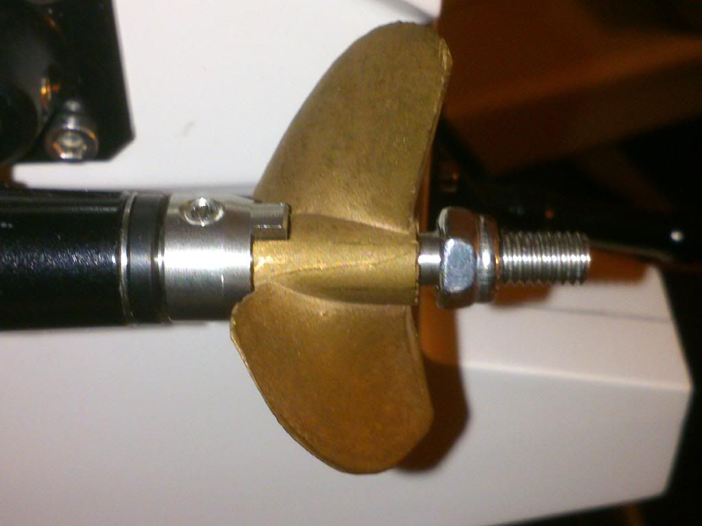

    Originally posted by srislash
    On my (brand new) HPR stuff, there is a 4mm or so spacer on the shaft. Guess that is what it is for.
    No, I have fitted the thrust washer but there is still a gap.. I guess I should post a picture...

      I know exactly what you are taking about. Kent and I explained what to do as we both encounter this problem. All the hpr and mhz boats that I have done worked out this way.

          Sorry Chris, I'm not sure it's a single washer fix but I will try... If not, I'll take a pick and post it...

            Ok, I had a look... 3 washers does it but I think I would rather just cut the thread down so it works as it should...
            I think maybe the drives were designed with bigger props in mind???

              What props are you running

                I'm wondering the same??? but it should take a 42mm with a washer no problem. Not sure about the thread thing, I think the drives are hardened S/S so might not be as easy? but I'm only guessing here. I used a 3/16 collar that has a grub screw (looks a bit like a flex saver and that worked perfect with no play it was about 1/4" tall and roughly as thick that the hub on the prop.

                    Ahh, feel like an idiot here. The spacer I spoke of is on my "clicks". Sorry Dave,Kent, Chris for sticking my butt in.
                    I assume they have the same is sure with smaller props.

                      Hi guys... The props I'm starting with are Octura 442's...
                      Here's a view of it... You can see
                      I think I'll go for a spacer but to me, it seems like a bodge! :-/

                        I cut b a piece of stainless down on my lathe that worked for 442's. Also i have turned down the hpr prop shafts a bunch of times. I also bored them to fit 5mm flex. I wouldn't attempt without the proper tools. Here's a funny story. I was at the lake one day and wanted to try smaller props from my usual prop realizing I left the little spacers home. I found a pen and cut the cap to fit with my knife. It worked fine for the time being, and I pulled just about 100mph. That day it was redneck racing.

                            Sorry this thread has slowed down so much... I am getting there with the battery trays fitted and I've made up some small 5mm long bushes to take up the gap on my props...
