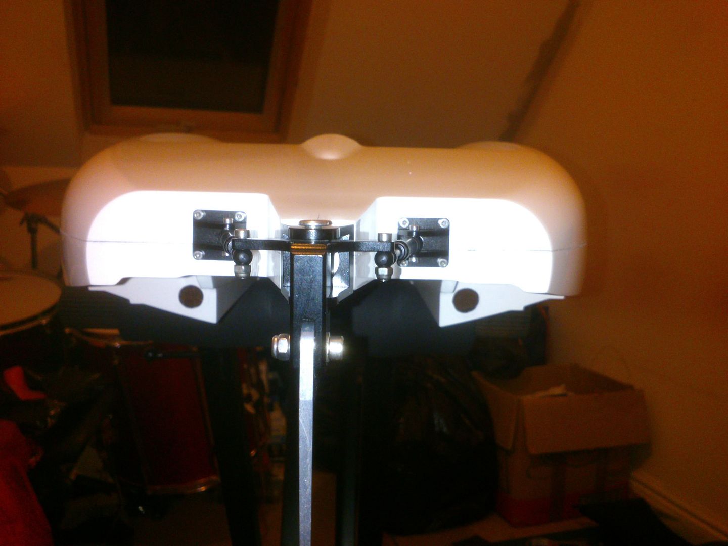

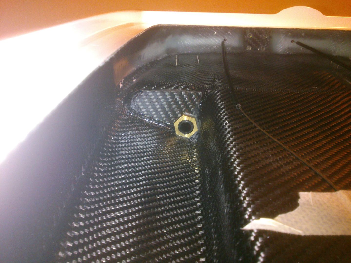

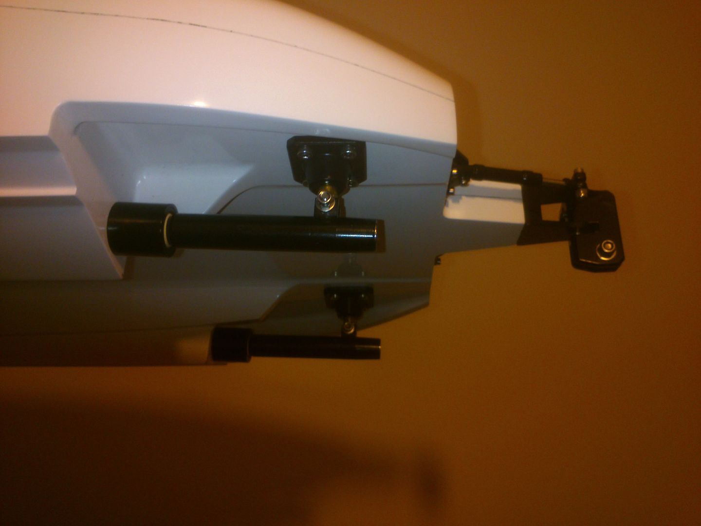

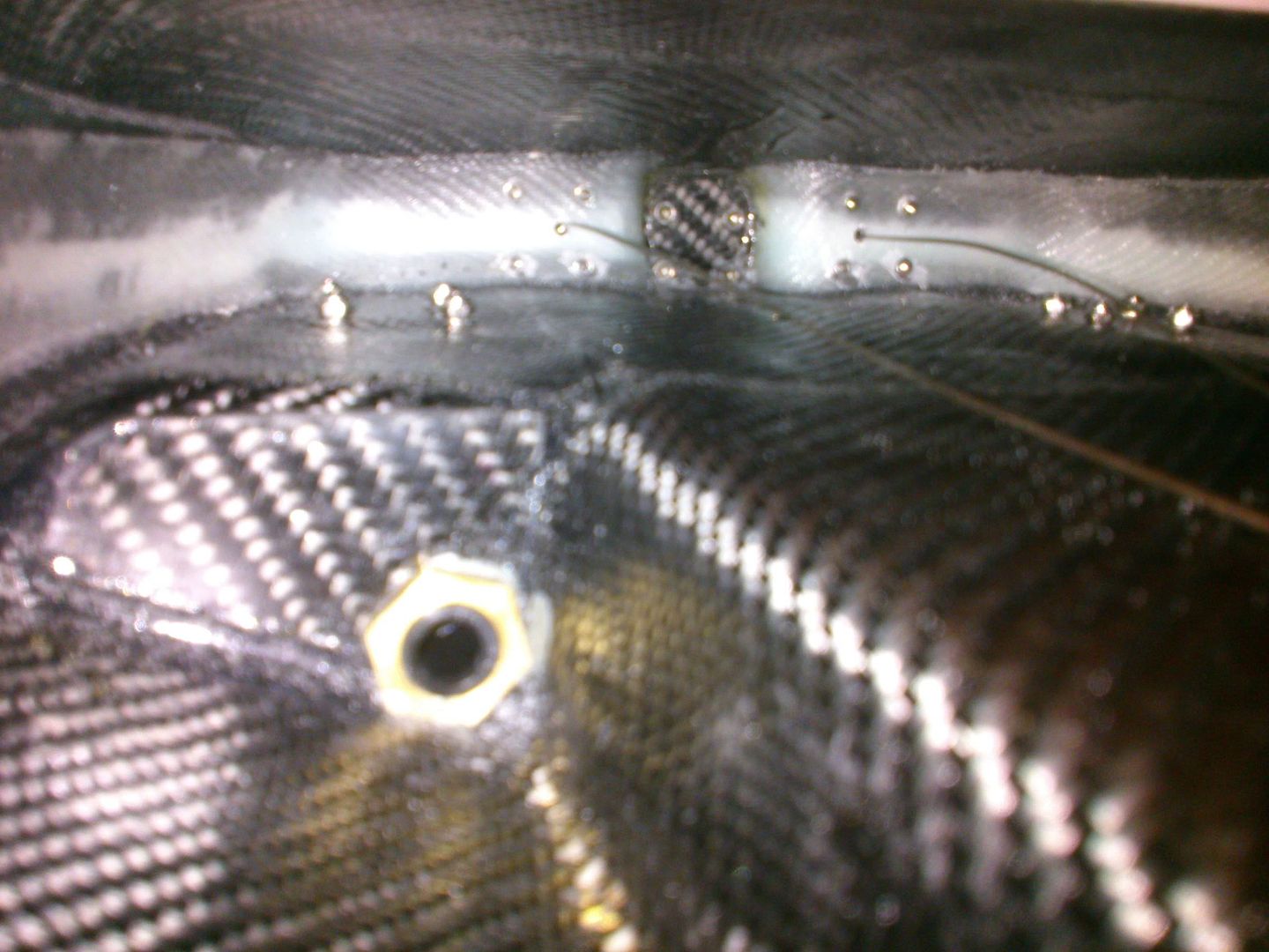

        Ok, there should be some pictures here???
        one of the drive height adjusters is about 1mm out of line but I can fix that.... I will be much happier when the rear end is buttoned up!!!
        At the moment, I need to shrink my hands so I can put the nuts on the drive posts :-/
        Clear out round the bolt heads for the rudder and resin it all in...
        As ever, all and any comments are welcome....
        HPR C-5009, Riptide48, PaynPak 1/12, Miss Budweiser 1/8 Hydro, Miss Freya (own design 1/8 Hydro), HOR 32, Twin 380 HOR 32, Magin one

          #34
          Looks great! Very clean. I am at about the same stage in my build (same hull) but it has taken me much longer to get here.
          I used fuel line to get the small rudder hydraulic nuts started. I think I saw that somewhere on here, and it worked well.
            Awesome idea! I'll give it a try, thanks!!! :-y

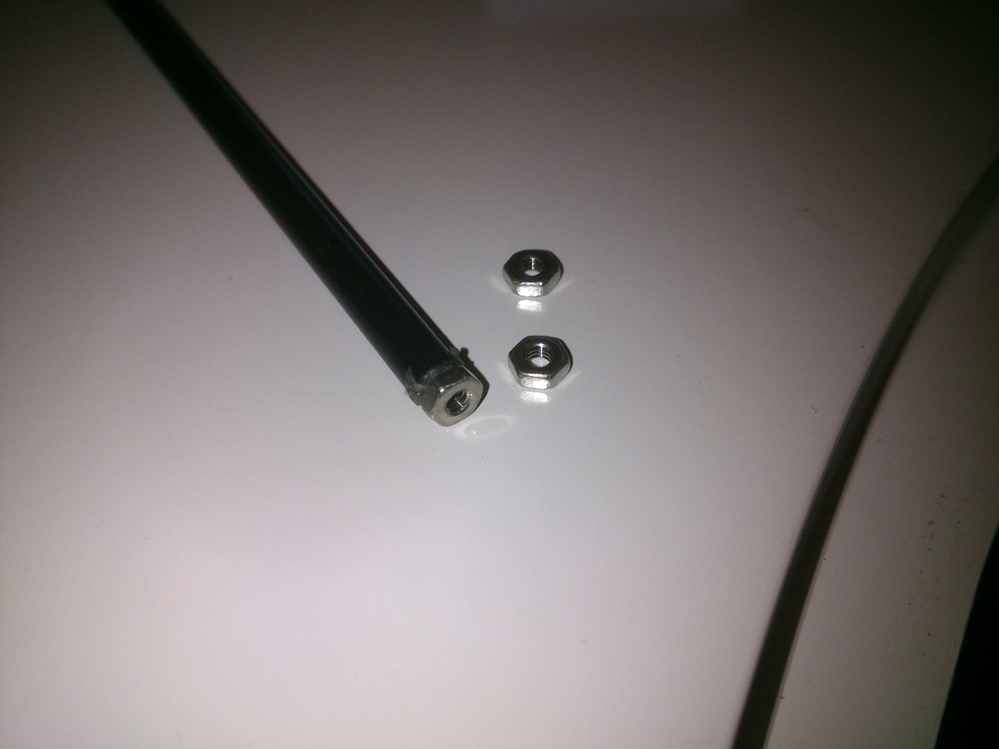

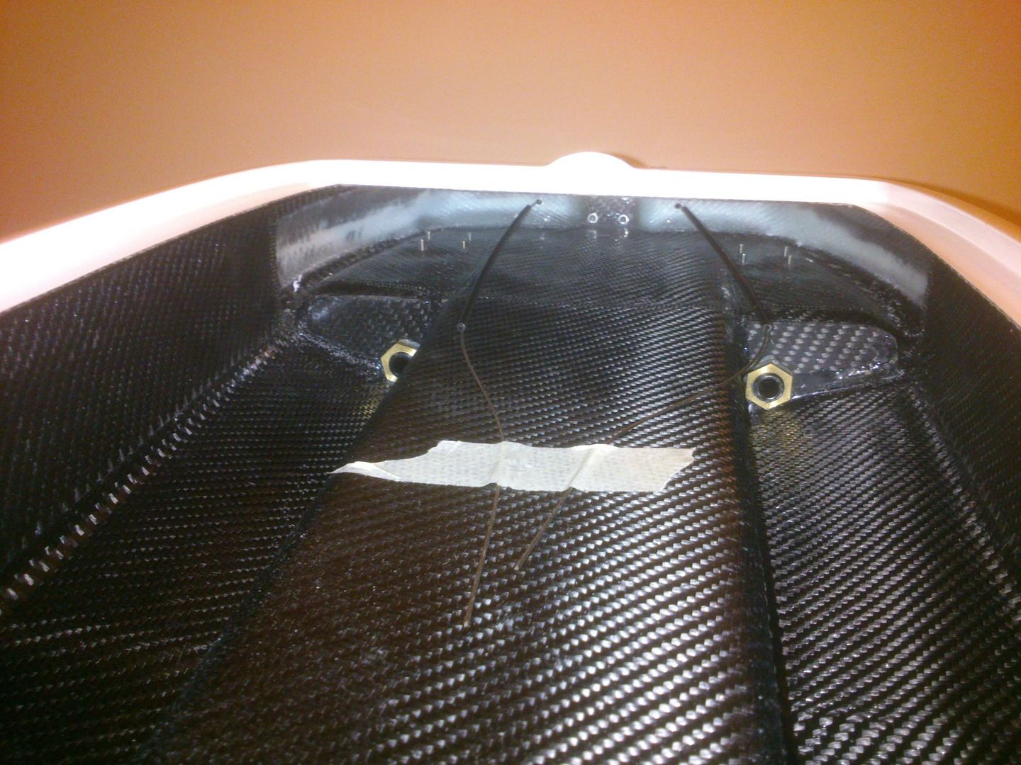

              Question....
              Hi folks,
              I have spent a little while fighting the fixings that hold the rear end together...
              Can anyone tell me if I need to resin this lot in?
              I will at some point be painting it so I will need to remove the rudder at least.... Around the drives will stay White so they can be masked of...

                #37
                Sorry about the quality of the pictures... :-/

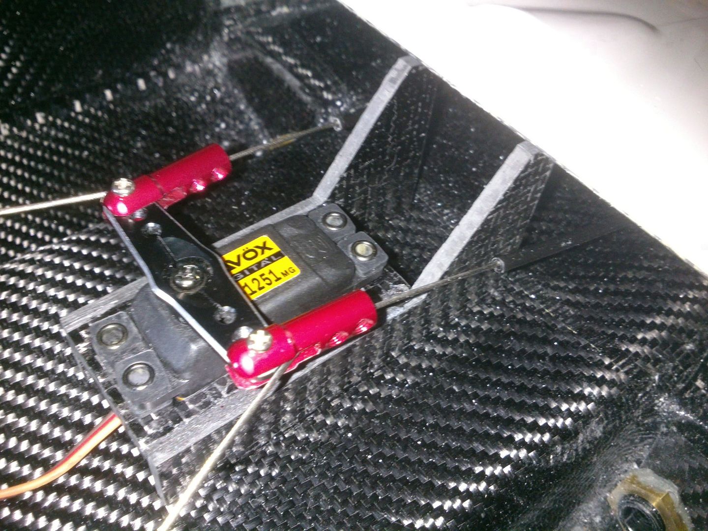

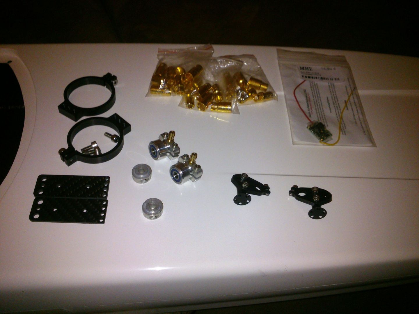

                        I've not done so much this week as I'm still waiting the motors but I did get some parts come....
                        And I've started to make motor mounts...
                        And a servo tray...
                        AND, made a start on the water pick ups....
                        It just dawned on me that I'm not finishing anything so today I will concentrate on the pickups and servo tray....
                        I know it's not much but I have lots to do elsewhere.... :-/
                        As ever, please do have a say so I know if I'm doing good or not.....

                              Well, What did I say about slow going???
                              What with work and doing family stuff and the store being closed, I didn't get much done...
                              I did get the servo box/tray finished though.
                              I also found that my "3/16" prop tubes are 7.1mm OD and the parts I got from MHZ are for 7mm tube.... 7mm tube and liner on order now...
