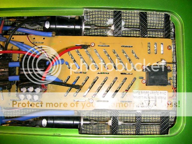

            I have been having a lot of fun with this boat. The boat has no high speed crashes yet. But it is in need of some work. The mounting points of the deck inside the hull that mounts the servo, all but one,broke loose and so I re did them with marine 2 part epoxy. I also added new battery mounts that lower the 6s lipos down low. This boat with the 45mm props runs great. I would guess that its around 60 mph with the stock motors (not bad). 15 min. run times and not heat issues.
            I will be adding some carbon fiber to the rudder mount from the inside soon and some webbing to the hull as well it will look much like the l400mm cat that I'm still working on someday. As a matter of fact I will be mounting my 8s lipos in the 1400mm hull the same way this boat is set up.

                    #84
                    pics!
                    As you can see the 8s lipos have lots of room. I atill need to add the plate that will conect between the two pieces of carbon that not only holds the battery tray but stiffenes the mount that holds the stuffing tubes. Pretty slick!
