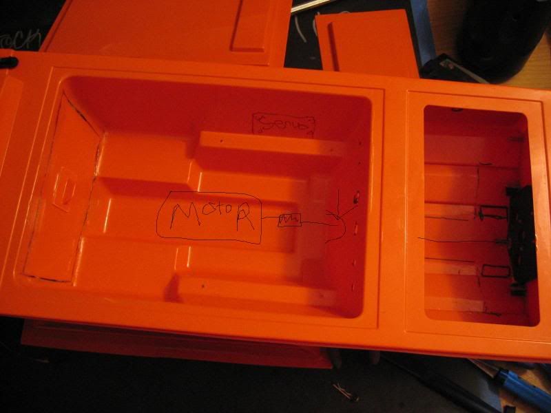

ok i was thinking of puting the motor in the middle compartment now.first of is the flex cable thick enough to use at that lenght without bending.second how will i waterproof that area that i need to cut the hole in order to do that .here is a pic the arrow is pointing to the hole im gonna have to cut out.please help i got no clue
the flex cable is in a teflon liner and then you put it in a brass pipe. So it can't really go anywhere. Just use epoxy to waterproof the outlet.
