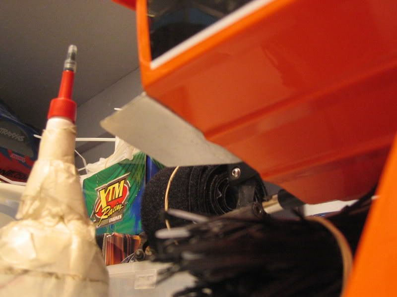

                    they are rite now exactly flat
                    i no about drag

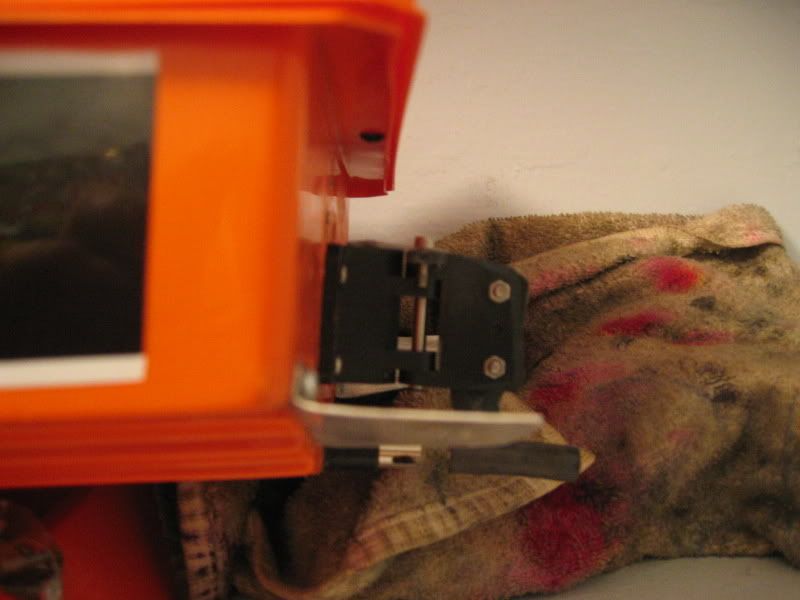

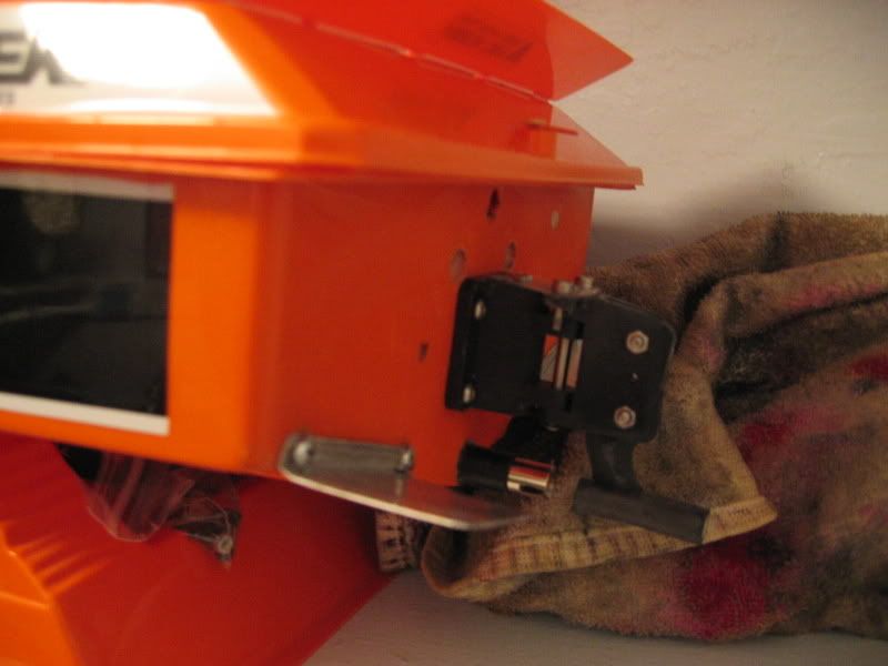

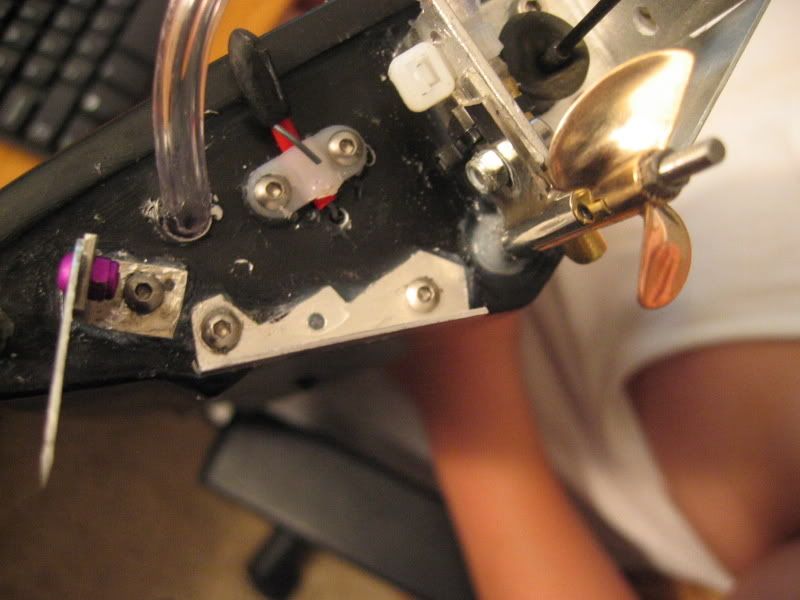

                      here is a pic of what i coppied of
                      {PHASES boat}
                      and mine (flat/leveld)

                        Wholly Cow he has alot of the prop shaft hangin out

                            move the notch out on the prop shaft, move your drive dog down so there arent as many threads hanging out.
                            probably gonna need to trim up the flex cable to get it to slide forward
