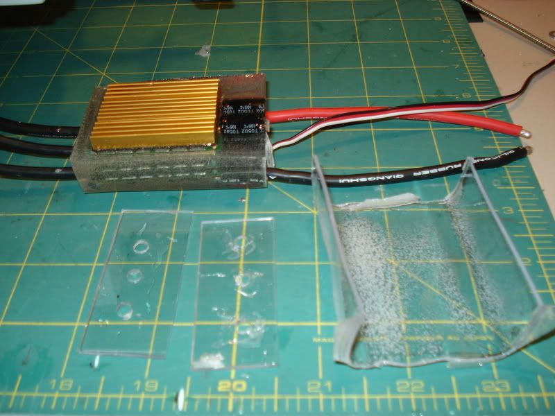

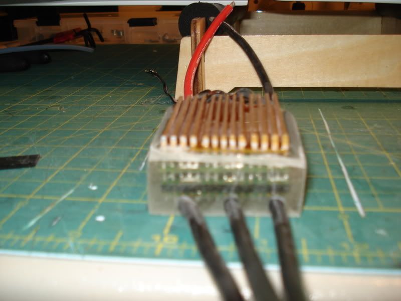

              My rotor arived today. Great work by Peter Z. Just by chance I happeded to finish the esc today. The mold popped off the esc in a snap. I sanded it down a bit. All thats left is the cooling plates. I am going to make a better fitting one for the next esc. I'll be testing on Sunday.

                `that esc will weigh a ton
                EYEKANDYGRAPHICS
                www.rclipos.com
                • SJFE
                  • 4735
                  150 grams and change. I'll shave it down more today.

                      Id say its w/p now!!!! hope it will dissapate heat. Abit overkill on the epoxy???
                      Maybe say by 1/2 a tube lol?? I just had to say it lol
                        I was always told a non-porous surface does not dissapate heat. However a wet esc does not create a happy SJFE!!!!

                          Have you guy's tried MG chemicals Conformal Spray Coating??
                          I have used a spray by MG chemicals,,, It is a conformal coating for vibration and water resistance,, much like the stuff Castle uses to waterproof thier esc's... I really like it, because it is easy to use, dries in 2-4 min.., and I have gotten a couple of these GX-200A esc's wet, and had no problems at all!!!
                          All I do is open it up from stock,, spray it with MG,, build a watercooling plate from K&S brass tube and plate,, then re-heat shrink it....
                          Nothing like keeping you lipos warm and your prop wet!!

                            I like SJFE's idea of total encapsulation... Reminds me of SV27 esc's and Kontronics Power-Jazz....
                            I cant wait to hear some feedback on how they perform.... Any testing SJFE???
                            • SJFE
                              • 4735
                              I am testing today but the Jolly s not ready. Just the little twin cat. The DP270 is a heat transfering epoxy with some good exotherm ratings. When I was sanding the bottom the entire block heated up pretty evenly. I should have it ready and tested by the middle of the week. Just waiting on the 70K Boca bearings for the KB.
