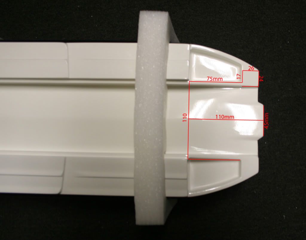

I need stingers (surface drives). Below are dimensions of the rear section of the hull. My first choice for drives would be these if I can get em longer (since I believe- and correct me if im wrong- I will need approx 140mm from transom support to prop hub) (http://www.mhzusa.com/Scale-Drive-fo...m-m-1674-A.htm), but I have tried getting into contact with MHZ multiple times via phone and e-mail with no response.
The real questions is this. How much- if any- distance difference can exist between say the leading edge of the center prop vs. the 2 outers?
