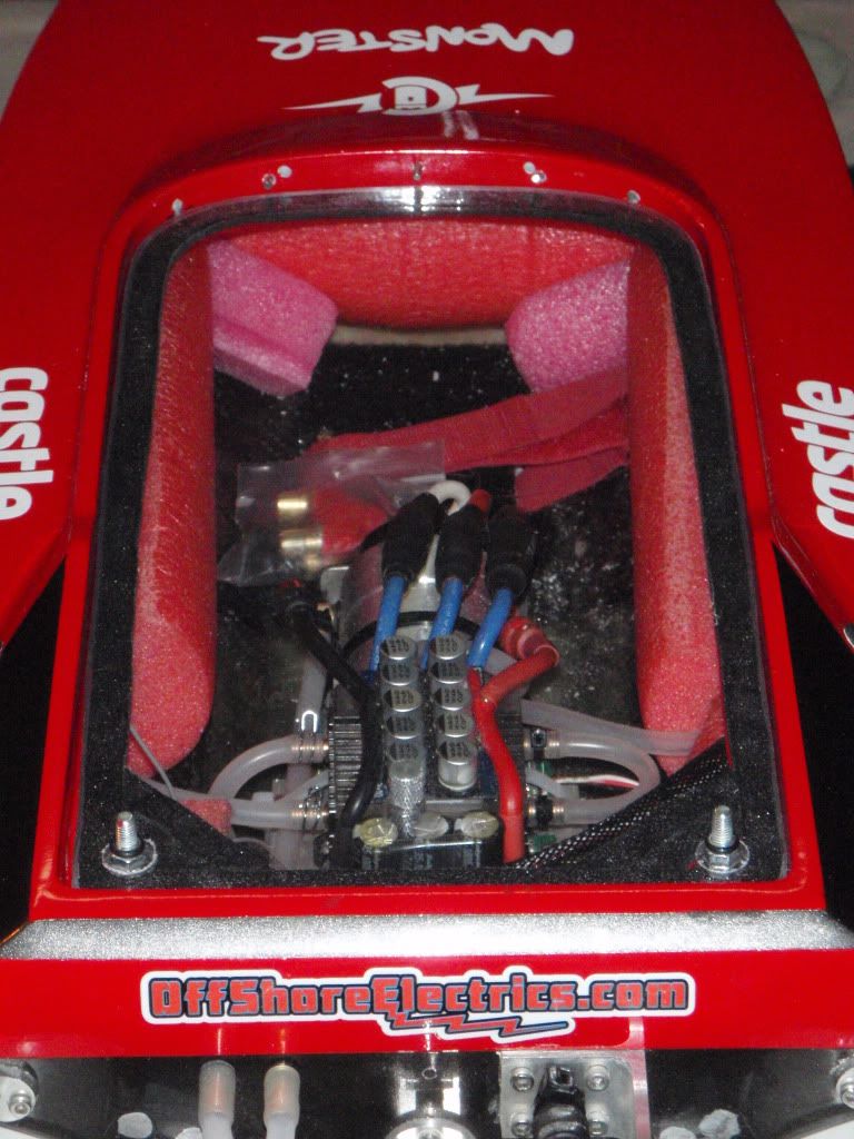

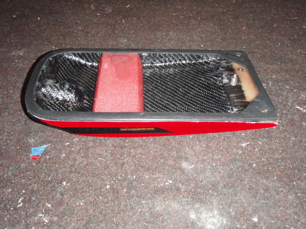

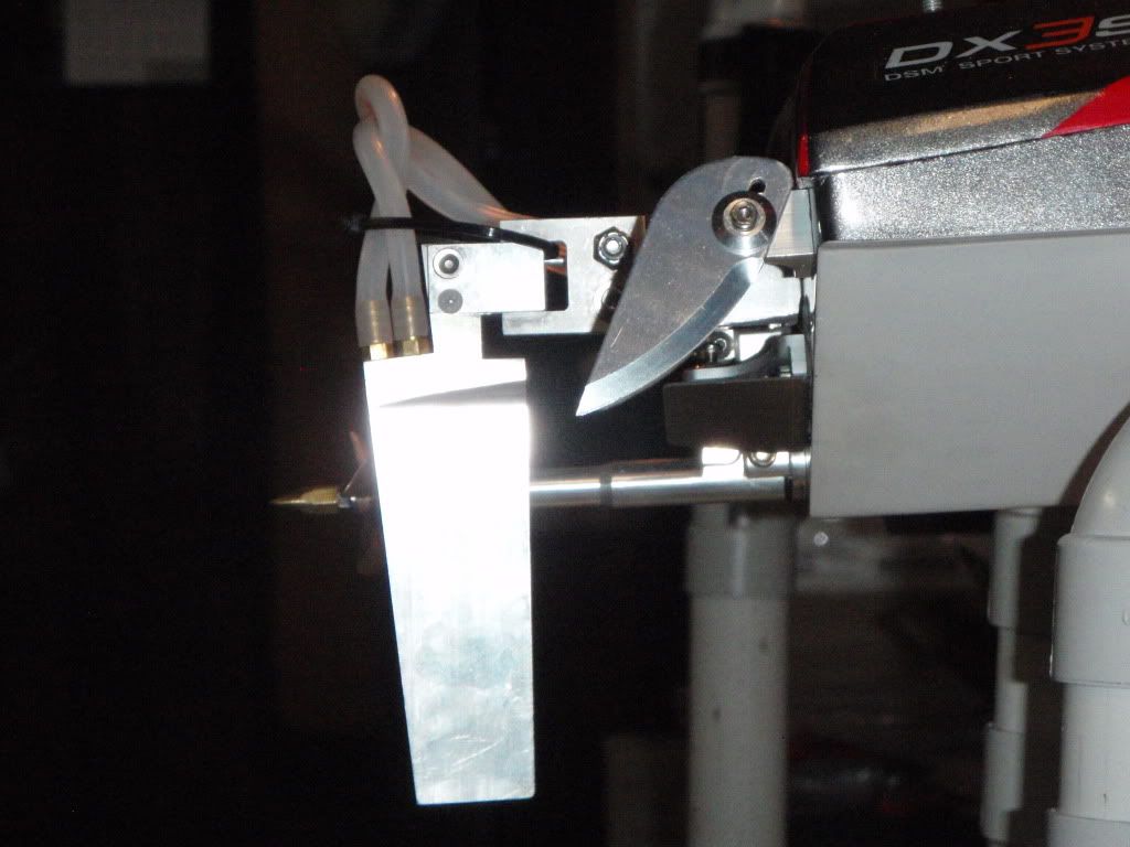

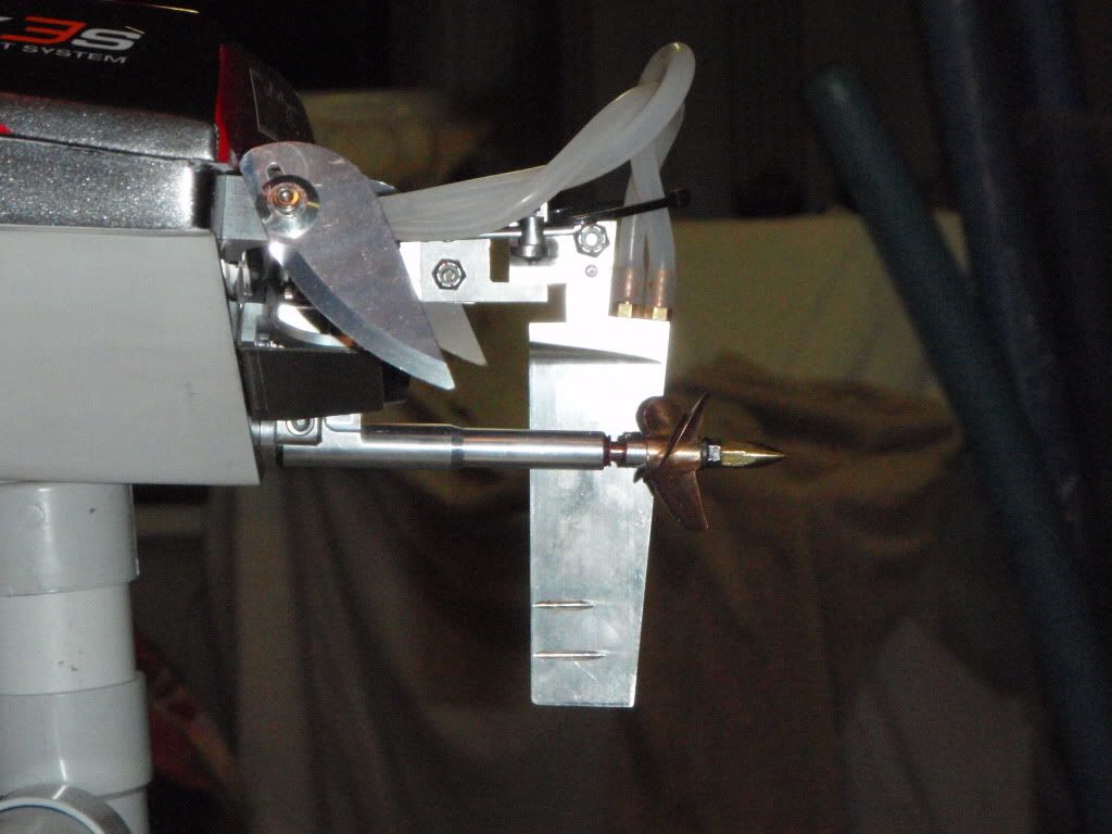

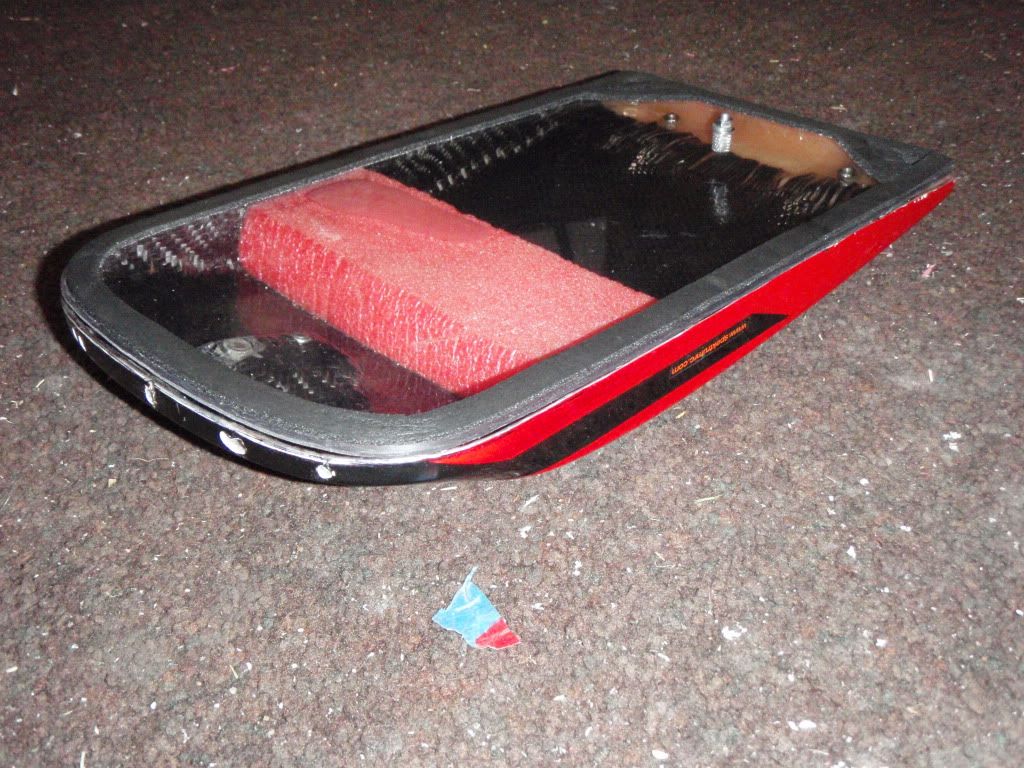

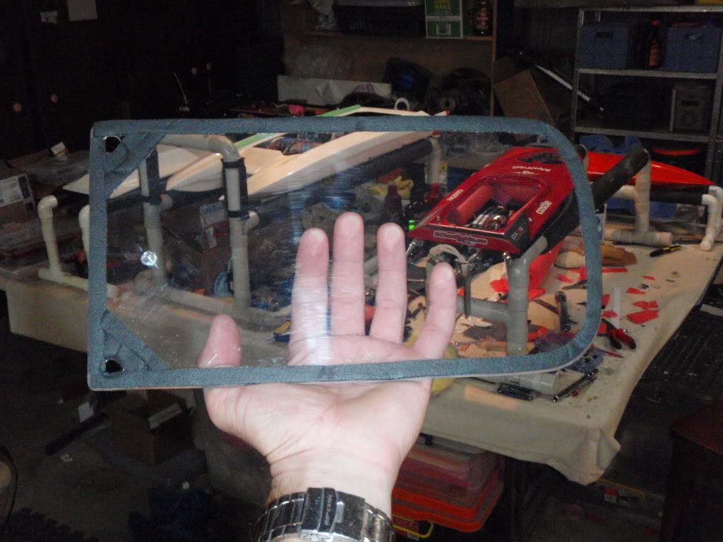

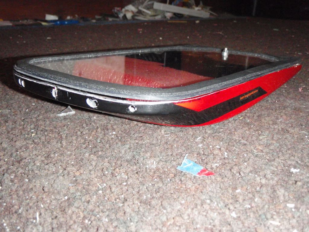

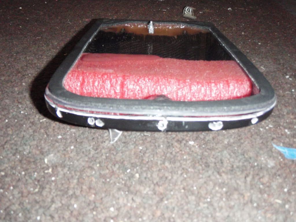

I did a little work on my titan last night and and managed to get some driving time in this afternoon so I have a few results to share. I had to change my trim tabs due to a crash that bent one back the wrong way last time I drove it, so I took the opportunity to reposition them better allowing more clearance for the prop and thought I'd fiddle with the stinger adjustment to see how a 1/2 turn up would ride. This afternoon was choppy and very windy and the only good thing to come out of it was a punishing test for the hatch and seal I'd been working on. It took me nearly 3 hours to take one set of lipo's from 16.80 down to 15.44 the result of bad weather, servo, driving and set up but it was a heap of fun and we got some cool footage. I plan on cutting the stinger down so the drive dog will line up, I think it's time this hull gets to see an inch or so of water surface.
Here's a few pic's of the hardwear and hatch seal.

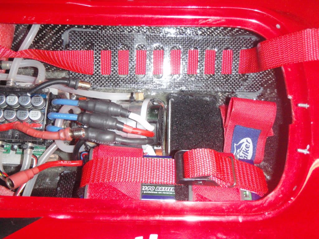

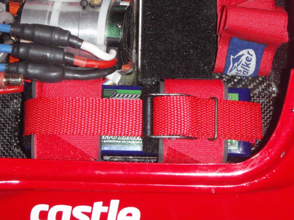

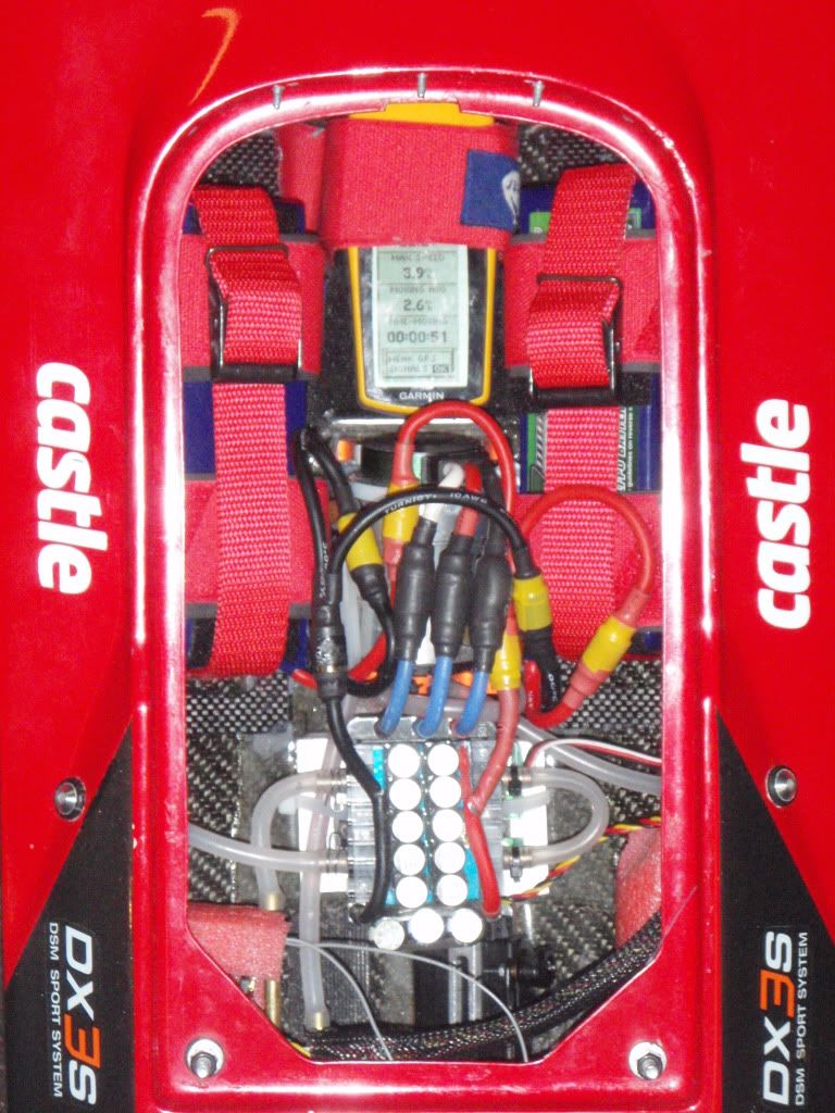

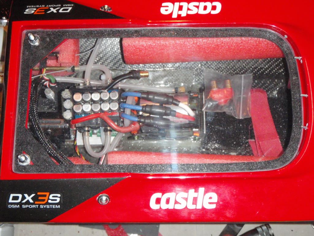

after almost a year of struggling to get the boat running well with the batteries up front causing a high COG in combination with the long stinger and finding that there is no hull in the water at high speed I have finally installed adjustable battery trays to bring the COG back and I've cut almost an inch off the stinger. I still need a few runs to get it right but she's a lot more stable and the last inch or so of the hull is in the water most of the time. Temps are not an issue in any way, I ran it for nearly 9 minutes last night and everything came in cool running a dasboata x442 and my speed has finally dropped to around 55mph and holds both the streights and turns well.
Here's a few pic's of my battery tray's and new layout.
