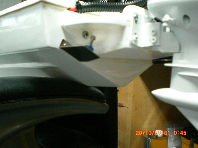

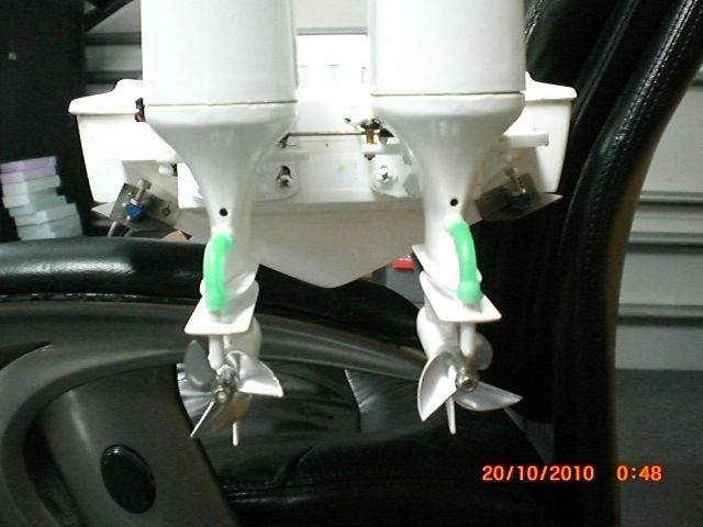

    Counter rotating props and trim tabs....
    Charging batteries and will do a test run. These props are 2 mm larger in diameter so I'm not sure how it will run.
    • ScarabChris
      • Oct 2010
      • 752
      #47
      OK I did a test run and its obvious these props are too much for these motors. Right away I can tell by the sound they make that they are loading up too much and the boat was slightly slower. The motors got hot and had that "smell" after just a few minutes of run.
      The original 2 blade props are 1.25" diameter (not sure of the pitch) and these new 3 blade props are 1.5" (36mm) diameter and 1.4 pitch.
      Anyone have a suggestion for props? I was counter rotating 3 blade cleaver props to keep with the scale theme. Or maybe some stronger motors? But then the gear will be the weak link. What a dilemma.
      Also....the motors are filling with water, not good. But the hoses might have been lose so I'll have to test that again.
      The upside is the trim tabs leveled the boat right out.

          My experience with these outboards and those brushed motors (are you running the stock silver canned motors???) is that they are kind of "draggy" and use a lot of power to turn the prop. Any more prop than an X435 or so is really going to be pushing things. I played around with one of these on the original AQ Bass Boat and the brushed setups just go really hot, and really didn't deliver the performance I was after.
          Do you know what pitch those 3-blade props are that you have on there??
          You might have better luck, if you want to stay with those outboards, if you switched over to a suitable Brushless 1/10th scale sized car/truck motor. Something like a 17.5 or 13.5 T would deliver much more torque than the 550 can motors would, and should bolt right on.

              The pitch on these 3 blades is 1.4 which appears to be identical to the stock 2 blades. The only difference seems to be the extra 2 mm in diameter and the extra blade.
              I just ordered some 3 blades with the same diameter and pitch as the stock 2 blades. We will see if they are better.

                  So, 1.4 sounds more like the pitch ratio than the actual pitch... Take the Pitch Ratio (1.4) and multiply it times the diameter to get the actual pitch.
                  That might help. If you could give the exact specs of the props, we might be able to help more.

                    What props did you end up with? Venom sells 32mm 3-blade aluminum counter rotating props that have a very scale appearance. They are fit a 4mm shaft.

                      Scott, Yes, those are the props I ordered. The 3 blades I have pictured above are Venom 36 mm but the plastic ones. Going from a 3 mm shaft to a 4 mm is easy, heat shrink the shaft until the prop fits snug.
