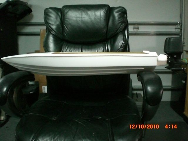

    The hull I am using is an Aeromarine 31" Challenger. I cut the deck out to resemble the cuddy cabin layout of my boat.

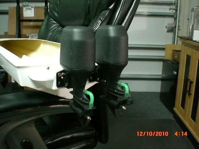

    I built an engine bracket to hold the electric outboards. I will also build a deck, console and radar arch.
    Motors dry fit, it will take some doing to get the CG and motor hight right, but I have rigged and hung motors on a few full scale boats including mine pictured above so i think I can get this one done.
