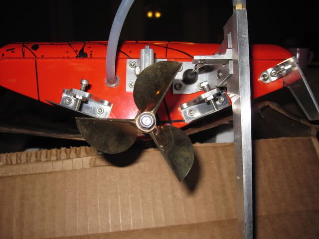

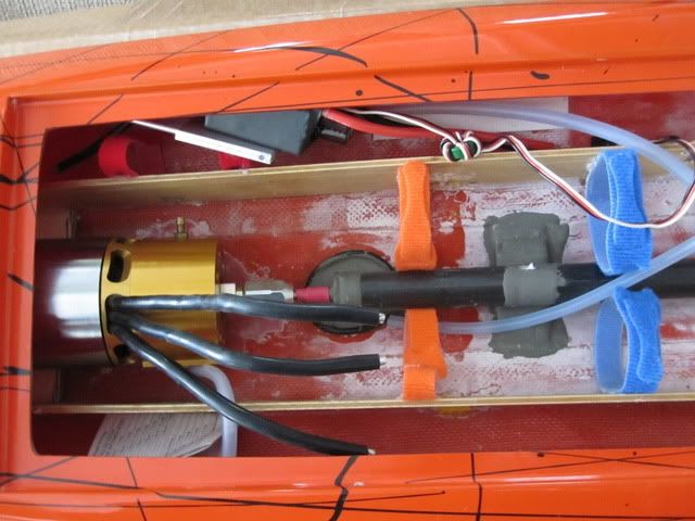

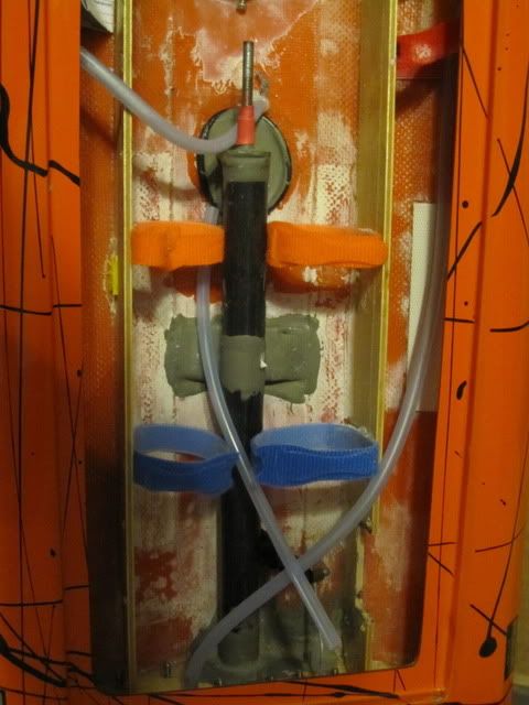

    Spots Rico 20 Mono build.
    I picked up a Rico 20 Mono hull from a member here. The hull was original build by Mad Mike with a wet well design. (kinda different/cool). I am going to put a Neu/castle 1515 1y on 4s-5s with a skywing 200amp esc.
    What prop would be a good starting point for this combo on 4s?

                          These hulls are awesome!! With a 1y I would start with a 442 and work your way up. Depending on how high your struts located a 37mm might not be enough diameter.
