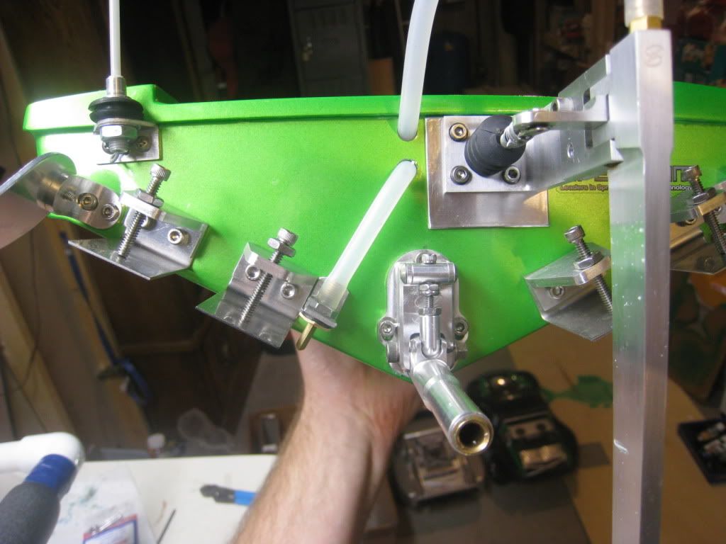

        I can't wait to check out the Neu 1521. Thanks again, sooner or later I'll get this stuff figured out. I decided to add a 2nd pick-up and outlet for added cooling in the new setup. It's an octura streamlined water pickup that I mounted on a bracket instead of in the bottom of the hull. Here are some pics.
        Hopefully it will flow a lot of water. I'm thinking it might pull in more water than the rudder. Not sure...

          Yep neus are definitely worth the money. Chuck is right. Everybody starts somewhere. I've learned everything from this forum as there really only me that runs fE here.
          I personally do not like that style of pickups. The rudder should be plenty enough.

                  Ya....I wasn't too sure on the pickup either, but I had a pretty weak stream coming from the outlet after going through the ESC, motor jacket, and motor mount. Plus...I'm all nervous about heat after cooking 3 motors. IDk... it seems like this pickup will flow more water than those vertical brass tube piece styles since it has a scoop to it.
