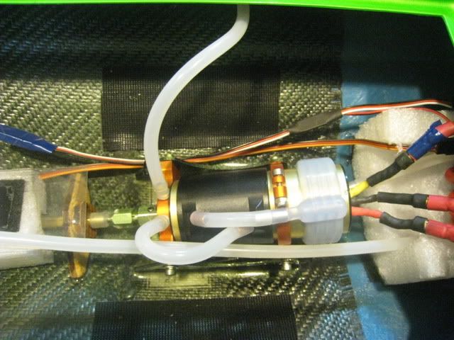

    Well,....I guess my fiago 540 xl doesn't like 6s. I thought I had the temps under control going down to a 42mm prop, but I totally cooked the motor. It was 270 deg! And smelled bad...

      Until I get some video (can't figure out how to get the vid off me cell phone...) can anyone tell by looking at my build if it looks like it could be "running wet"? I did a few searches and am still not sure what running wet means? Just trying to figure out my heat issue.

          Oh really? Ok, that makes sense now. Ya mine isn't running wet then. Well maybe it was just a bum motor. We'll see how the ammo 36-88 1280kv runs once I get it. I'll make sure not to run more than 30 seconds to a minute at a time without checking the temps. Thanks for the explaination!

            Got the ammo installed with dual water jackets. We'll see how this motor works. Hopefully today....

                What rudder did you use and how far from the transom is the motor ??

                  You betcha. It flew before on 6s until the fiegao cooked. I only have about 30 mins run time on this boat so far. I hope it will hold together for a lot longer now with this motor.
                    Thanks
                    I believe the rudder is a speedmaster 21, and the motor is about 9.5" from the transom.

                      Got the boat out today with the new motor and....cooked it.

                        Well I must say that if you cooked two motors so quick you need to check your driveline and or setup cause something ain't right. Bummer was hoping you got it sorted out. She's a really nice looking boat.

                          Thanks, ya, IDK WTF is going on. I ran 30 seconds, checked the temps, can was 110 rear of the motor near the bearing was 140. ran another 30 seconds and the can was 120 and the end was 145. So I ran 3/4 throttle for 2 mins and....dead in the water. no idea on temps since I had to wait for it to drift in. Video is uploading now. All this on a dumb little 40mm prop! performance was crap also with the 40mm. The 42mm was much better. I'll go check the vids.
