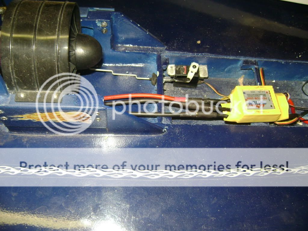

        Thanks for the explanation on the timing thing.
        It is not that I "don't want" to shorten the wires to the motor, I just don’t know if I can do too much. I took some pictures; the distance from the radio box bulkhead to the stern is 7” (17.78 cm.). I bent the motor wires as suggested and pulled the slack out of the wires. I might be able to take 2” (2.54 cm) out of the extension wires. This, with the 4” (5.08 cm.) taken off the ESC, I can remove a total of 6” (7.62 cm) from the mess.
        Worst case scenario, I can tear out the existing bulkhead and move it back another 2”. The only “problem” with this is the extra work and refinishing to the hull. Not a real big deal, just time consuming. This would take the original 15” of wire and shorten it to 7” (17.78 cm.).
        There have been no comments on switching from 12 ga to 10 ga wire, is it not a significant change?
        Projects like this are real learning experiences!!! Let’s hope we learn from our mistakes.

          Without taking a saw to the hull, I still see at least 4-5" of useless wire that can be cut off the motor side of the ESC.
          As for using 10 gauge instead of 12 - no material difference. The length is the problem. As long as your wires are - and with the problems you are having - anything practical to reduce the wire length is worth it to improve performance and reliability.

                          The length of the new extension wires is 10.5” (26.67cm), I might be able to remove another inch. The wires on the ESC have been shortened to about 1” (2.54cm).
                              This is much better! At least try it this way and see how it performs. The longest motor wire length - from ESC board to motor can - on any of my boats is about 7". That's longer than I like but it works fine.

                                Is it possible to move the fan unit a couple of inches forward to reduce your wire length a bit more? Looks like you have a bit of room on the mount.
                                You could add a tube to the rear of the unit so it still ends just in front of the rudder if that is a requirement.
