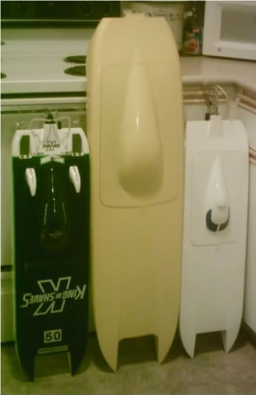

                        Hull came in wed. and it is everything I didn't want!!!!
                        I ordered JBS decalls but that don't matter,
                        I was going to order a small and large hull aswell, but not now!
                        I don't even know if I will complete the boat, because.......
                        It Is Fuggin Yellow!!!
                        sure they said send it back and we will send you out a white one, but why must I come out of pocket to correct someone elses mistake
                        OK, You Go First!!!
                        • Boatman
                          • Jan 2008
                          • 796
                          I'm tellin ya. I posted a while back somewhere that MHZ is loosin it. Send them a complaint and all you get is an auto responder. Their phones dont work half the time and their products are becoming even more odd ball hit and miss. Too bad about the hull but hopefully you an make it work. Still a pretty hull

                            You were going to paint it?
                            Randy
                            BBY Racing
                            • Tuslow1
                              • 154
                              True, I was going to paint it. But I got the JBS Stickers so that the painter could use them as a guide to paint them on and use my name KES insted of JBS. Painting the whole hull white is a waste of time and money, for any little scratch will reveal the boats true colors. So the only thing this hull is good for is a Miss Geico Rep. By the way, I hate Miss Geico!
