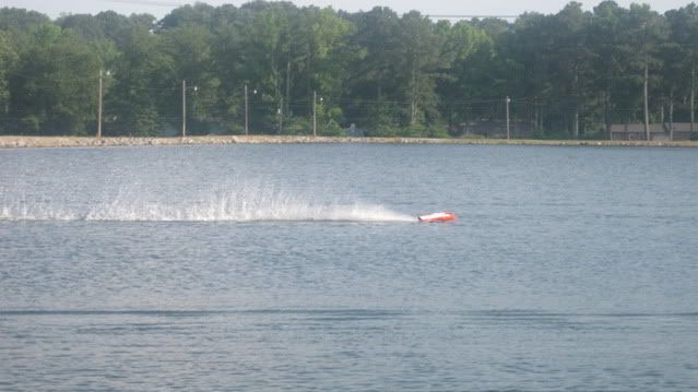

                                #30
                                My setup on my boat was totally different, so my strut depth will be setup for a little more power, plus my CG is different than yours, so its hard to say.
                                Here's how my boat ran most of the time, walking ass lol
