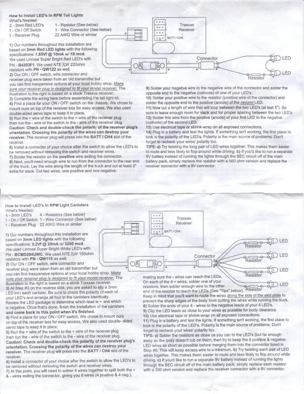

hey gents... i m looking to wire up 6 led's for my slash... 4 for the front and 2 reds for the rear... going for a desert truck looks... i have downloaded the rpm instructions and it looks pretty clear but i m wondering if some electronic experts here can help me... sorry about the size of the downloads...
i d like to add 2 more sets of wires (for the rears) to the bottom set of instructions... would it be OK to just run 2 more sets of wires (4 total strands - to power the red RED led's) where the 4 sets of wires exit AFTER the 'connector' ??
hopefully that makes sense... i don t see any reason why it wouldn t work... maybe i ll need to put in different resistors or lower 'mcd' LED's ??
i ll be running the lights off the rx... it s a spektrum sr3000... using a dx2.0 tx...
i m piecing together the stuff i need this week and i d like to get this thing dialled ASAP... hopefully some people with alot more experience with wiring LEDs can help me out
