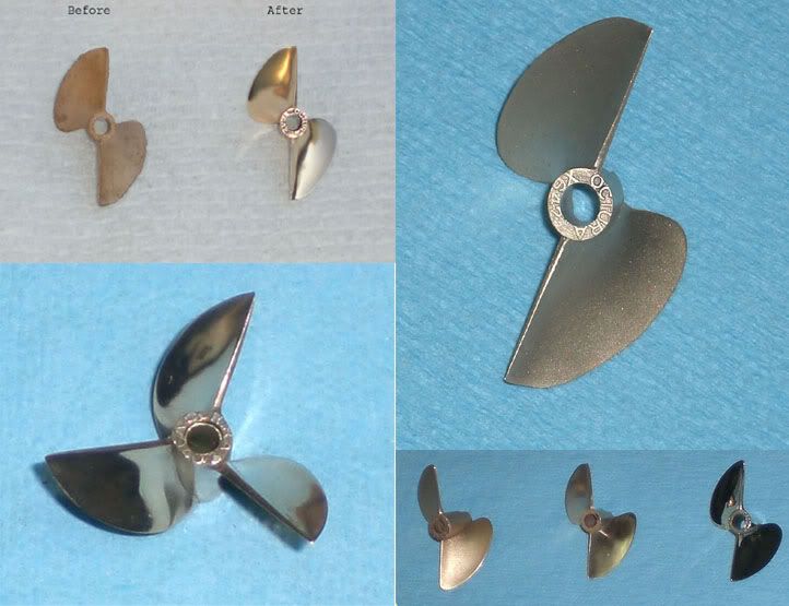

    PROP WORK
    I can sharpen, balance, detongue, and cup props in a variety of finishes to suit your needs. I will work with you on a one on one basis to deliver exactly what you need. My prices are fair and I ship priority mail all over the world unless other arrangements are made ahead of time. I have more pictures in my profile album under props and in the gallery.
    You can ask questions here or send me a PM if you like. Prices vary depending on the prop, size, number of blades, material, and all that you may want done to it. I am a premier PayPal verified member.

                              Not meant as critics , but : why do I never see the trailing-edge worked ?
                              (the only person I know of doing so is Andy Brown)
                              Don't they have to be very sharp aswell ?
                              Lots of tuned props have rounded trailing edges, due to the polishing............
                              Ps : I like the Octura 642 a lot ! , the edges on this one look great
