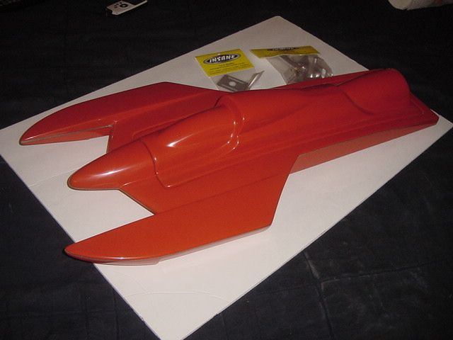

    Because I was an international order (Australia) I needed to contact Jeff Michaud at Insane via email detailing exactly the hull, colours, decals and hardware I wanted, along with a full mailing address so that Jeff could put together a quote for the boat, and the international shipping required to get it here. Australia is a long way from the US, so, shipping a larger item like a boat hull is going to cost you if you live a similar distance away. But completely doable if you're up for it.
    Once Insane boats has the hull ready, Tony will pick it up from them and begin his work. You just need to make sure you let Insane know that Tony will be along to pick up the hull.

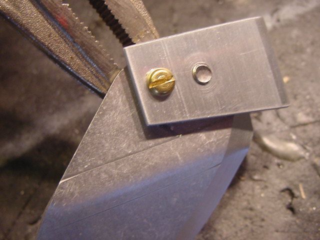

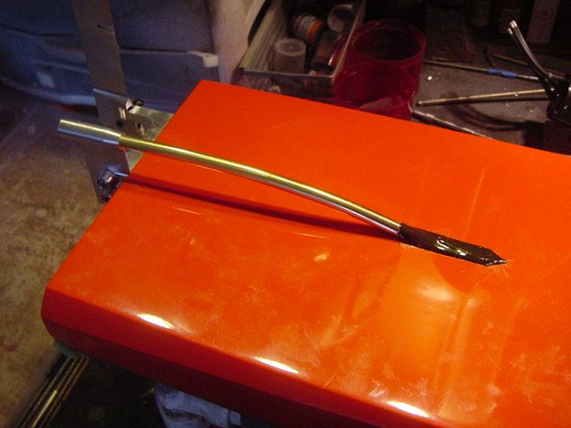

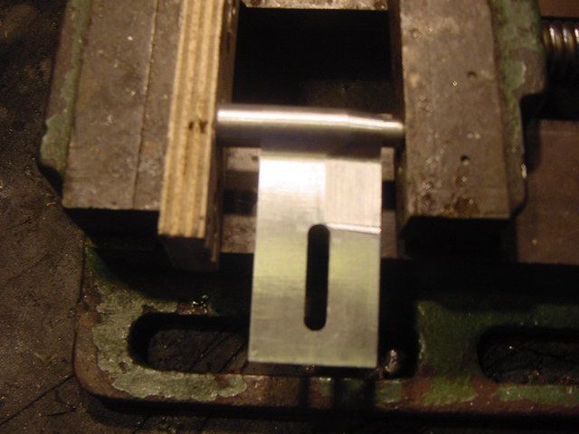

    Brass shear bolt added to the turn fin

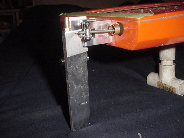

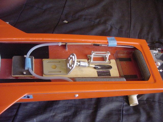

    Servo rod pass through & rudder assembly added
    PHOTO BY PROPERCHOPPER

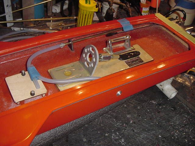

    Lining up and setting out internals

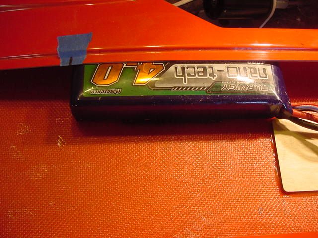

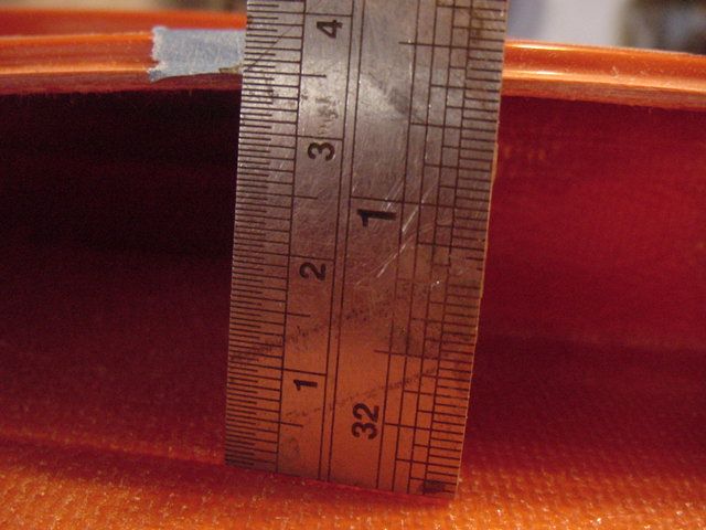

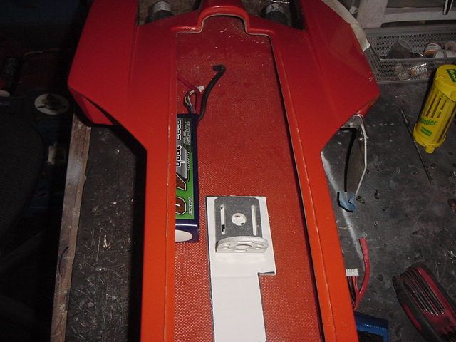

    Measuring space for batteries
    We had a discussion about batteries, because Tony knew that space within the FE30 hull was limited, especially if you wish to run 2 batteries along either side of the hull. Also, Tony advised that too much weight loaded into the FE30 hull could keep the nose down too much and greatly increase the chance of wave stuffing. Stuffing, if you're wondering, is where the nose of the boat catches the surface of the water, and the boat submarines down into the depths. larger waves across a lake surface can cause this, as the wave momentarily raises the water's surface.
    I had some 4S 5000mah Thunder Power batteries I was hoping to use. But, the weight of the 5000mah batts alone would likely have caused the issues above, plus they were simply too big to fit where they needed to go. So then it was either a case of sourcing some 4S 4000mah Turnigy Nanotech, or 4s 4000mah Dinogy Nanotech batteries, because Tony knew that those batteries would fit. A little research on the topic quickly had me choosing the Dinogy batteries.
    Tony ordered these for me, and simply included the batteries in with the boat hull when it shipped. Problem solved. We agreed to just add the price of the Dinogy's onto the final Paypal bill.

    Setup for battery positioning
    PHOTO BY ME
    Just going to quote Tony right here.
    "The way I configure the layout allows a single 4S 5000 pack to be used in front of the ESC - just between the front of the ESC and the front hatch opening. Trouble is that the 1515 1Y is pretty amp hungry and most racers that have tried that config can't get a 2 1/2 minute heat in without endangering the battery. The conventional setup is to use two 4S 4000 packs on each side of the ESC - plenty of capacity PLUS the added weight helps keep the boat on the water in racewater chop. This creates two issues : the ESC needs to be modded to use 90 degree waterline fitings to narrow it down providing clearance for the batteries (pictured)."

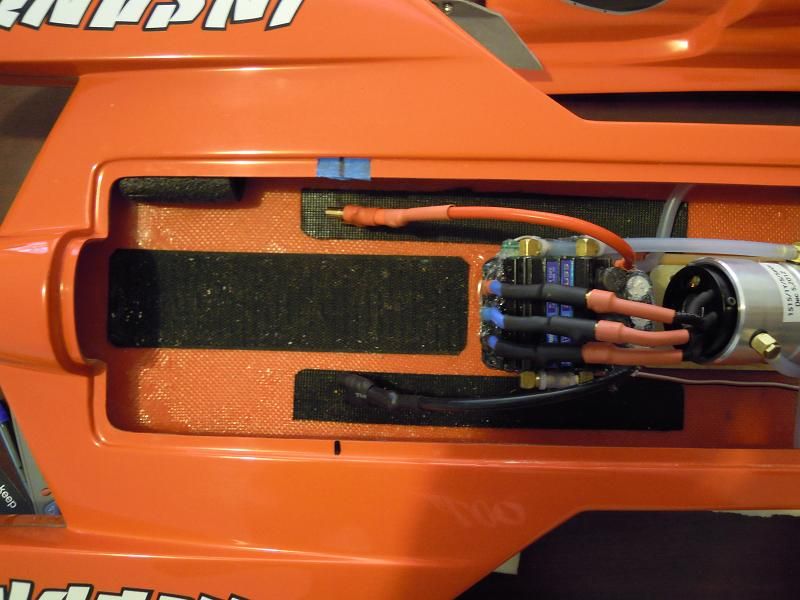

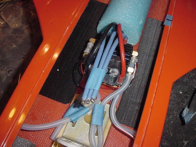

      90 degree fittings used to MOD ESC
      Tony modded the ESC for me. Initially we discussed what ESC I had in mind, and I just went with the old stalwart of today, the Seaking 180. Tony ordered it for me from OSE, and then modded it with the 90 degree fittings once it arrived. All part of the service if you agree to have him mod it for you. I wasn't so sure I could pull it off with the tools I have here, or the know how. Again, we just added the cost of the ESC onto the final bill.

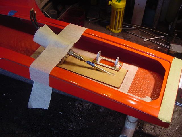

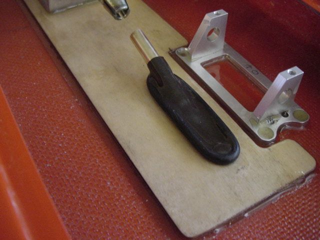

      Inserting the Stuffing tube
      Finishing the stuffing tube hull entry

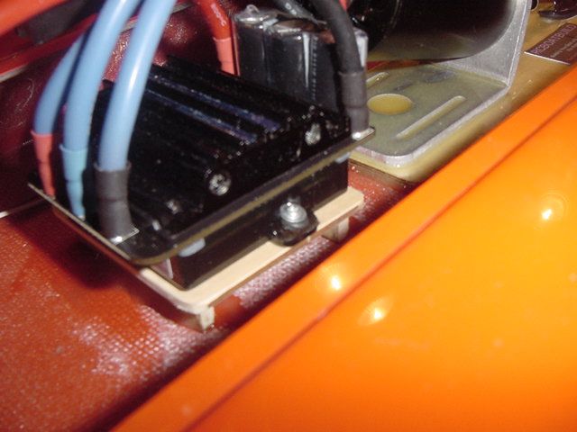

      ESC Installed
      You can see that Tony puts the ESC up on a raised platform. He builds it that way in case you get water inside the hull while running the boat. The water can slosh around on the floor of the hull while the ESC sits up high and dry. Another little area where some experience goes a long way.

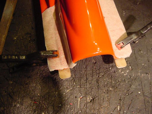

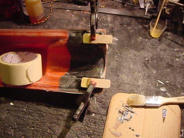

        Hatch Retention tab installation

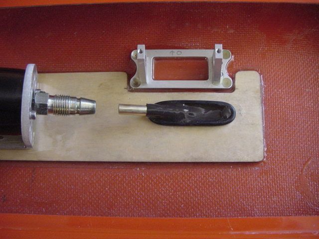

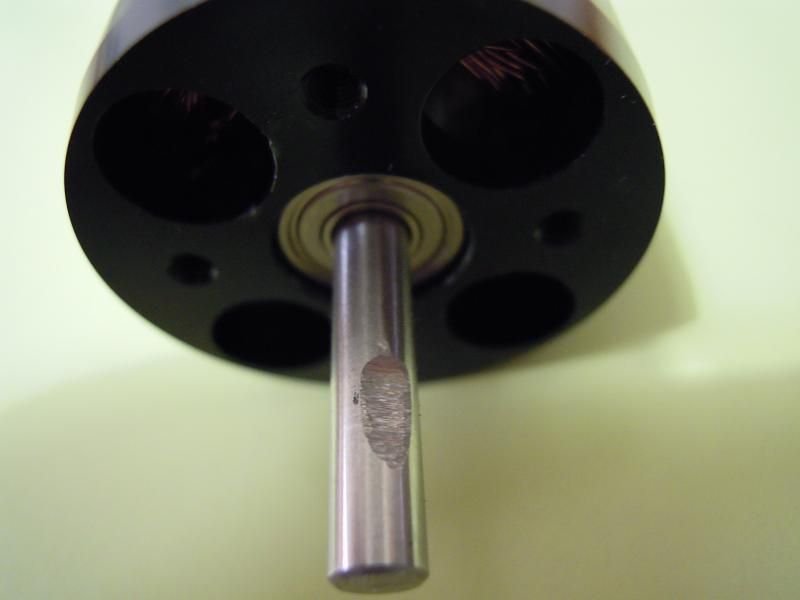

          Grinding a flat onto the shaft of the NEU Motor
          PHOTO BY ME
          Tony built the boat up to the level that I wanted, which in this case was pretty much ready to run. All that was left for me to do was install the motor, servo, and the radio gear. Very simple stuff for boating enthusiasts to do. I also had to solder some 5.5mm bullet connectors onto all the battery and motor leads. Tony offered to do that soldering for me, but I wanted at least some of the fun.
          I chose a decent motor. I went with the NEU 1515 1Y, which I bought from OSE. Neu Motors do not come with flats on the shafts, so I needed to grind one in place with a Dremel tool. This took about a minute to do. Very very easy with the right tools.

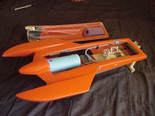

          First Run Load Out
          PHOTO BY ME

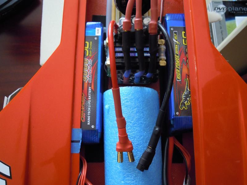

          So here's the completed internal layout with batteries, steering servo, and radio gear loaded. Tony crafts some foam rubber pool noodles to fit most blank spaces and provide flotation should something nasty happen and you end up with more water inside the hull than you wanted. You can see how tight things are with the batteries installed at each side and ESC in the middle. So now the need to modify the ESC with those 90 degree fittings is made pretty clear isn't it. Despite how it appears, the batteries are actually easy to install. You pull that blue pool noodle foam out, and then you get a bendy plastic ruler, and slide the batteries into place on top of the ruler. Then just pull the ruler out when you've got the right position. Easy. To remove, you do the same, just slide the ruler under the battery to break the velcro's grip and pull the battery and ruler out at the same time. Cinch.
          You can see I went with the Traxxas 'waterproof' servo and a Tactic receiver. No particular reason for either choice. The waterproof claim of the Traxxas servo sounded good to me, and I have one of those in another boat which hasn't missed a beat so far. With a few Ready to Run boats in my repertoire now I have a collection of Tactic gear. Cheap & cheerful I'll fully admit, but actually none of my Tactic gear has missed a beat so far at all. I have several boats all bound to one Tactic controller as well, which is so easy to do it ain't funny.
          First Run Load Out II
          PHOTO BY ME

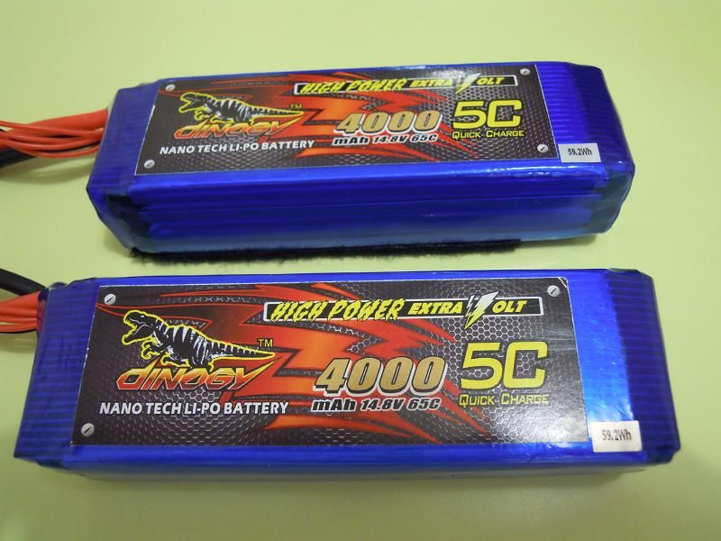

          So you can see I'm running the boat on 4S, with two 4000mah Dinogy's in Parallel.

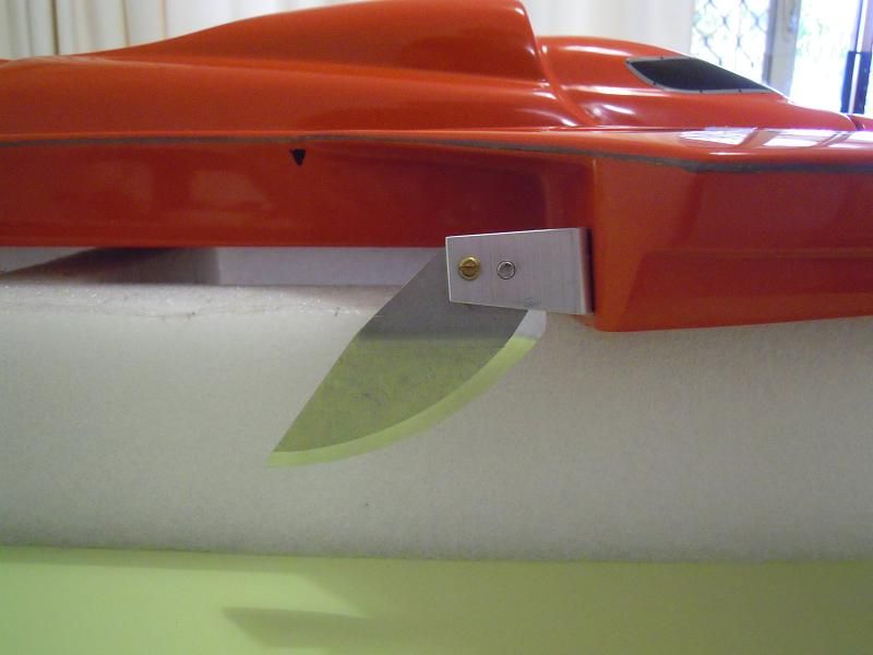

          Setting the turn fin Position
          PHOTO BY ME
          The very last thing I had to do was set the positioning of the turn fin. Tony advised to set it keeping the fold in the fin parallel to the hull. Easy done, 2 minute job.
