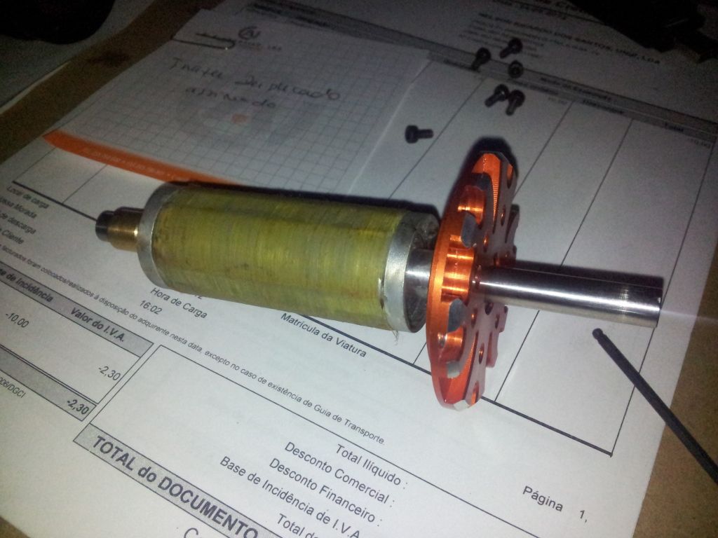

                  Hello Guys
                  Mine X524 motor have arrived yesterday..First thing i did whas to open for seeing it inside...
                  Here follows some pics.. :
                  Waiting for inputs!
                  The finish seems better on the sky rc motor compared to TP5850, bearings are from NSK, the shaft is correctly grounded...
                  The water coolet seems to loose.
                  Altough, from appearance TP 5850 seems to handle a lot better bigger amps, due to higher content of cooper compared to Sky rc!
                  Best Regards

                    #84
                    I like show & tell.
                    Looks identicle to the inside of my HK Version.
                    Thanks for sharing!
                    The one thing not so hot is how the rear connectors are pressed into the endbell.
                    I tried an 8mm connector I had kicking around (cheapo ones) and they were so tight I almost pulled the whole connector out with the female and white nylon/ptfe sleeve! They are soldered well inside so, hopefully its not buggered.
                    The 8mm it comes with are not as tight and may not do that as bad...

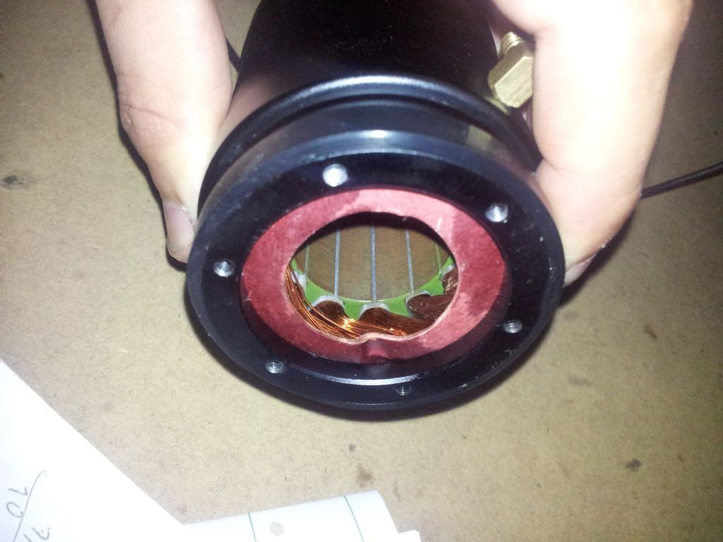

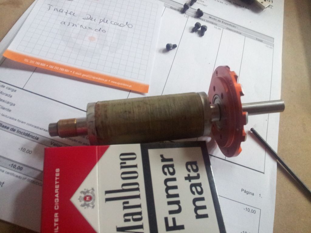

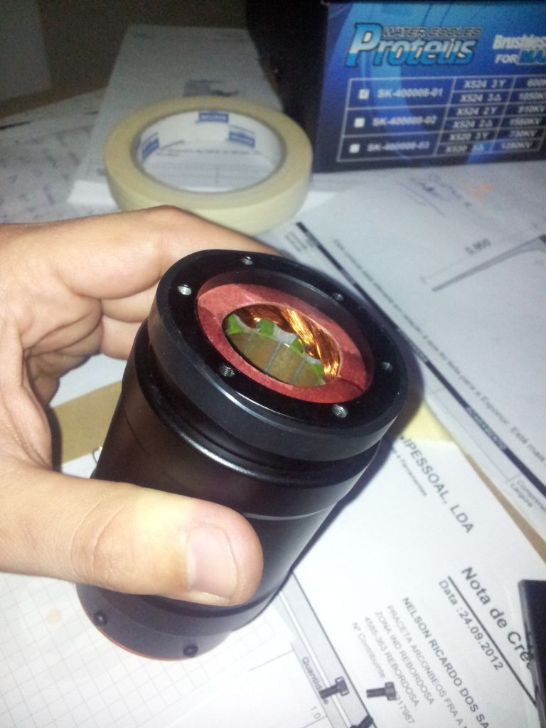

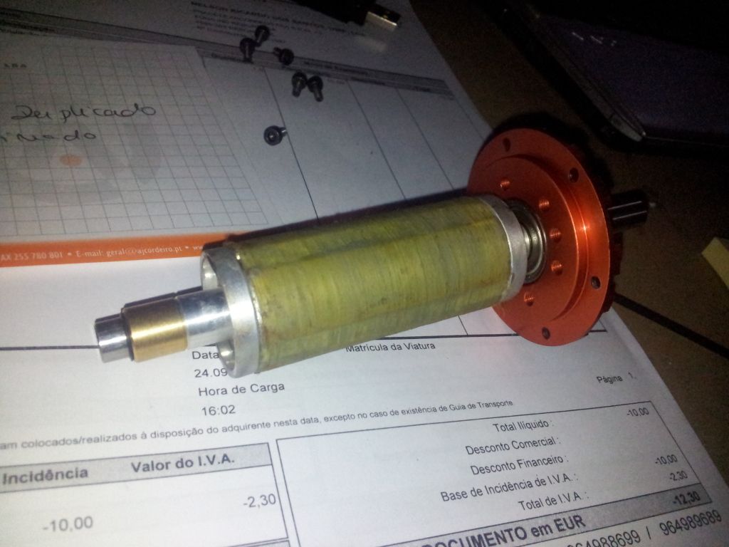

                                #90
                                Proteus X524 Inisde
                                Hello Guys
                                Has soon has i ha oportunity i opened the back and took some pictures....
                                Has i told you, and i guess i wasn´t mistaken, TP 5850 motor is far superior to the X524 motor.....
                                As you can see from the pics, there is almost 0.6 inch from the back that doesn´t have "stator" area, wich leads to a "efective rotor" about the same lenght and diameter has the leopard 5692...
                                Only after trying it, i could lead to "real" performance opinion, but from speculation, i think it´s a deceptive motor...It´s like having a 527 cubic inch block, with 350 capacity....
                                Efective magnet length is 64mm about 2.52 inch!
                                Can anyone give input for stator efective length of leopard 5692 motor?
                                Best Regards
