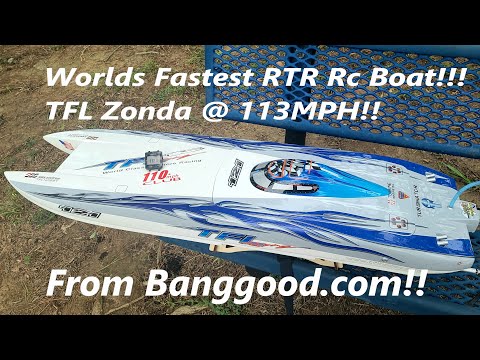

          Here is my latest run making the TFL Zonda "The Worlds fastest RTR Boat" (running factory stock electronics). The boat hit 113mph by the gps devices and the props used were from Chris Hoffmann (dasboata). More to come!
