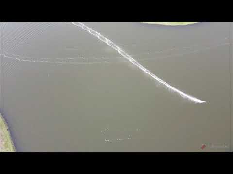

    I forgot to include my actual running videos... Here is the one from today (3rd time running it):
    She is running 62 Kmh (that's very close to 40 mph, for you American folks). It is running quite cool, so I could go to a better prop, but, then again, I would also need a better lake...

      Lots of bouncing. You might try more weight forward or a small amount of negative trim on the strut. I would move weight first, assuming you're strut is set relatively neutral to begin with. Nice to finally see it running!
