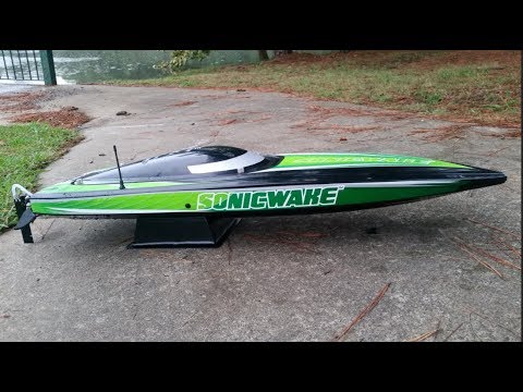

    First run on My new Pro Boat "Sonicwake" 36 self righting boat. The gps logger got 64mph and the gps devices got it at 63mph. This run was right out of the box except for a prop swap. https://www.youtube.com/watch?v=JEZs9EmC5P0&t=14s

          looking good Mark get that boat to lay down a bit and make a full pass ,,you should be near 70 MPH good job man

            Thanks Chris! You got something coming your way I'll talk to you about later. I'm thinking it might get mid 60's to maybe 70mph once I put one of the good props on it. Got to tame her down a little though.

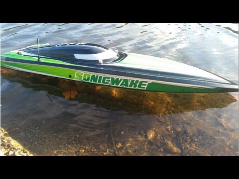

              Here is my second run breaking 60mph again. https://www.youtube.com/watch?v=3WMV2AW-tRE

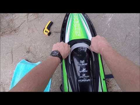

                  Thanks! I went over all bolts and screws and I added Loctite where needed and found the rudder mounting screws were a little loose. I took the strut bushing out and sanded a little on it so it would spin free and put a cable saver on the flex shaft. I did add a few drops of 3 in 1 oil on the hatch bolts and ran them in a couple of times to get the threads broken in and that's about it. Good luck with yours.

                              My Pro Boat Sonicwake hits 69 stock!
                              Here is my latest run of 69mphwith a prop from Chris Hoffmann (dasboata).. Rafael please have Horizon fix the "maps" compatibility issue for the Dynamite gps logger...They no longer display on them on the PC....
                              Edit: The map portion is now somewhat working again so I have attached an updated photo from the data logger to show where the boat actually hit 69mph at which was right in front of the dock on the first pass.
