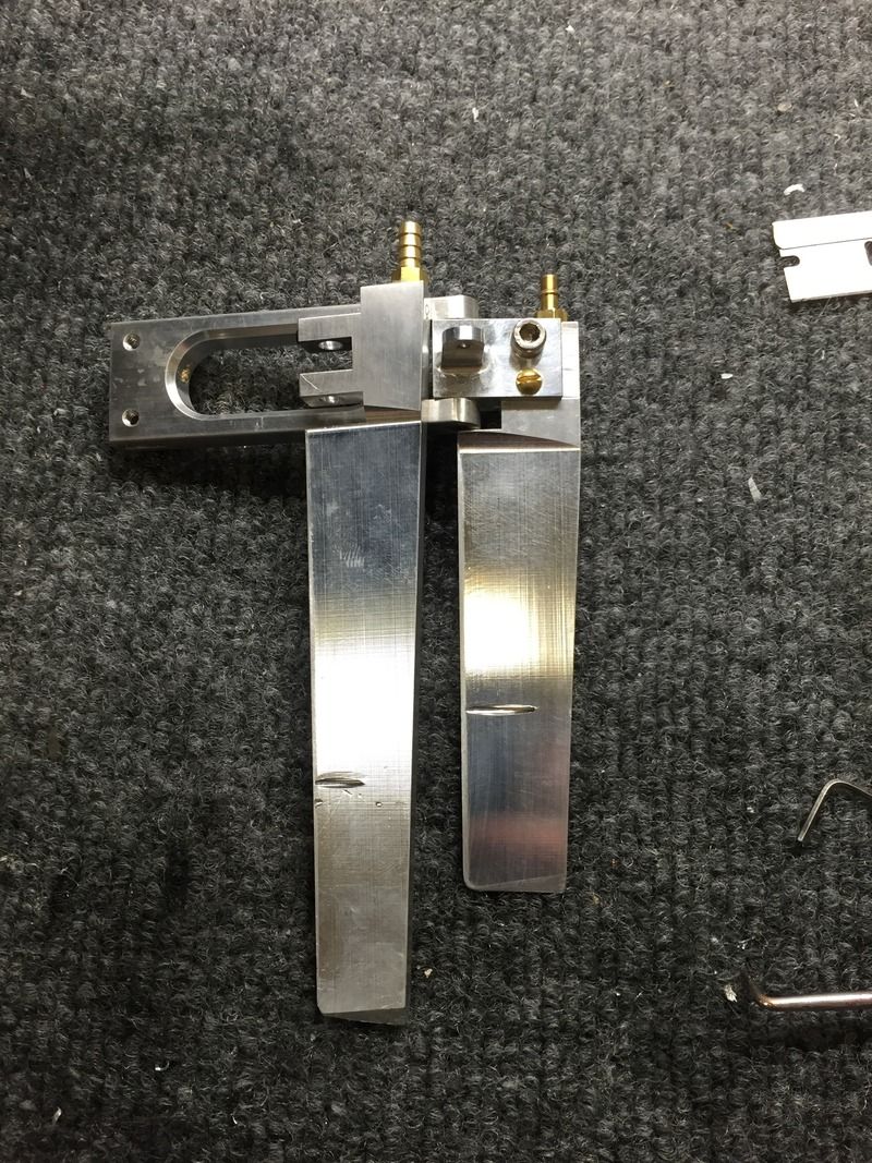

            Beautiful boat. Try moving batteries to the front to stop that wawawawa. Also the rudder length will affect it too. If you can source extra rudders try cutting some off. Before you cut it shorter tho, here's a trick that's helps me a lot, I do this on all my boats now...I sharpen the bottom of the rudder to a v shape. Try that first. Like this

              Ya I had it running pretty smooth but testing a different prop for top speed. I'll try the rudder shorting and sharpening as well. But heat racing at 64mph smooth as can be.. I love this boat..

                Here's how I've been doing mine, saw it a couple years ago from the Voodoo guys. What motor are you running?

                  That's how guys in my club have started running there's.. seems to take hopping out to..

                          Oscar, are those slots swept straight or upward forward the bow?
