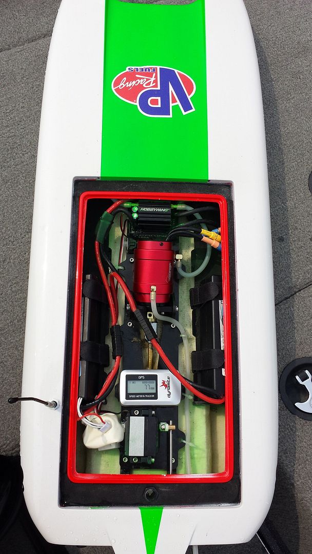

    Well as some of you may know i have been tinkering with this BJ 29 V3 with some different motors and props etc. Well today i took the latest setup to the lake and ran 77-78mph back to back constant speeds using the 4074 2200KV with a sharpened and balanced X442 prop from Rocket City Racing. The boat was very stable for these speeds and this size of hull. I do have one time on video where it hit a little wake and about lifted at almost 80mph!!! But i backed off the throttle and it eased right back into the water.... Hull is VERY predictable and flys well ! This thing has been a blast and handles FAR better then i ever thought it would.
    Here is the first run got a pic of the GPS here in the boat.

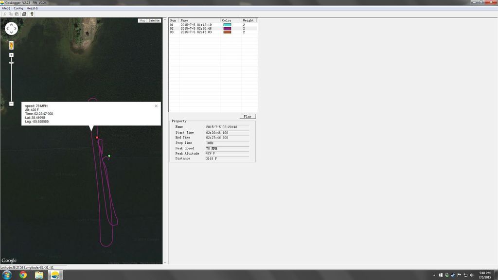

    Went for another run after charging the batteries and got 78 MPH here didnt get a pic of the GPS but i do have the GPS data screen shot!

    Nice, what batteries are you using?
    • Blevins
      • Feb 2014
      • 20
      2X 3cell SMC 7200mah 60C for 6s.

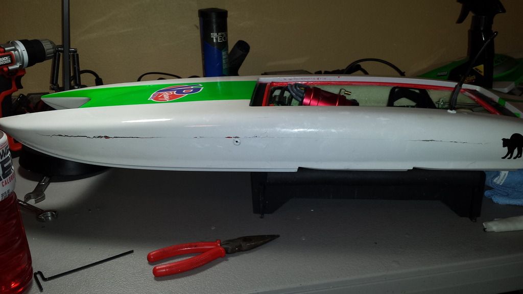

                        Well guys when a customer of mine found out this had happened he reminded me he was a certified diver... Guess what we found tonight on the bottom of the pond.... It was still beeping! So i assume the ESC is ok and the batterys as well. The balance connector wires fell out of the connectors and had some crud around them... Not sure if i want to try and fix that or just get some new batterys and toss them. What do you all think? Also i blew the motor out it really well and it seems to turn just fine! should i spray some wd-40 down in it or???

                            BTW Just tested my ESC and motor and they are working perfectly!
                            So what hull should i get next that will perform like this with my motor "4074 2200kv" but stay together if it happens to take flight again??

                              Just another one of those and reinforce it and add a bit more floatation to it. I can't think of anything that will turn that well and go that speed.
