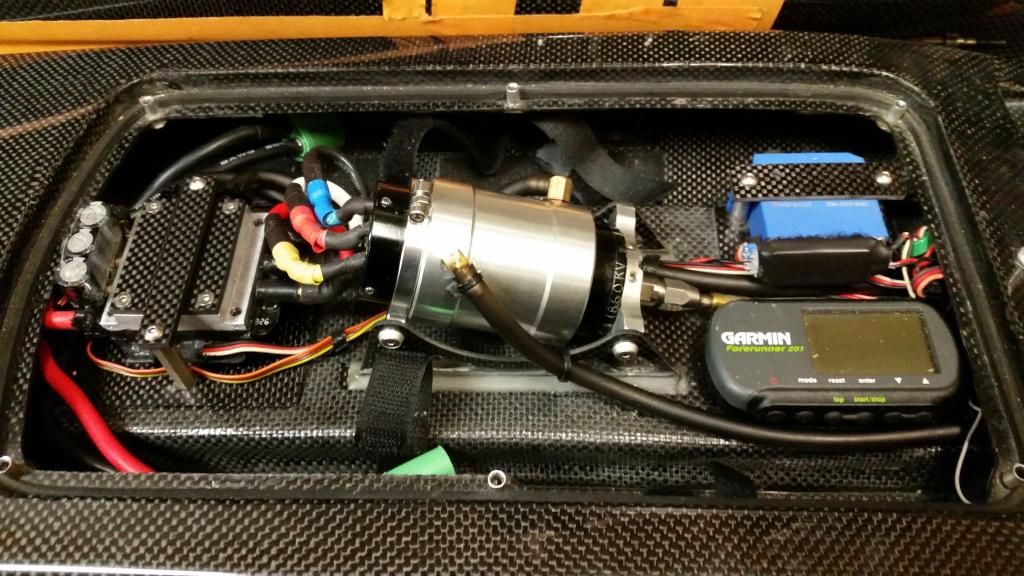

    So here's the 1521 in it...

                  Time for another update. I made a few small changes in hopes of breaking 90mph. I wasn't sure it was gonna do it but every weekend it gets a touch faster. I used a 1/4" shorter rudder, rounded the face of the drive dog and tried some revolectrix batteries. Still on 7s like before. Well....it was outstanding to say the least!
                  Here's the pic....

                          Bravo Travis. So which ESC in there ATM?
                            • 8750
                            #28
                            T180.....I want to try a swordfish 240 tho. I think it will put the power down more than the t180. ....

                                Well first off, I tried a etti 7s controller which was supposed to be more efficient. ...it was even though it wasn't enough amps for my setup. I picked up about 1mph...which exceeded any previous speed I've attained. Put the T180 back in...dropped back to the same mph.
                                Next...ive been talking to keith here and there and he seems to think the same thing...the t180 is not meant to be run on 7s like I'm doing and I could benefit from a true hv esc...
                                And lastly, I've read several times where people have picked up mph going from a t180 to a swordfish or a flier (type) esc including someone who posted right above you.
                                I may try 8s just for the heck of it, but I want to get what I can get of of my setup as it is. Then I plan on backing down the cell count and raising kv and a few other things just to see how I can do on 6s or 4s.
