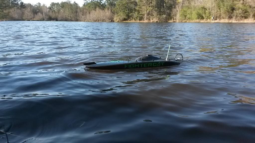

    Up until now the only reliable boat I have is my cheetah. Well I only have two running right now so I guess I should say it's my go to boat if I don't want to have problems. Had a little bad luck with my rivercat last time out so I guess I'm a little gun shy. Well today I had an awesome time running both of them. The rivercat ran flawlessly. Here's the setup details...
    2200kv 1515 castle motor
    Fightercat 101 esc
    Octura 442 prop
    All my batteries I ran are 5000mah 50c
    Strut level, 1/8" above flat on the table
    First I started on 4s....ran for a bit, checked everything... Ran cool. Ran those batts out.
    Next, 5s...same thing. Esc barely warm and motor barely warm. I recharged my 3s pack and decided to carefully try it on 6s. Same thing. Barely got warm. It boogies on 6s.my cheetah does 62.0mph and I think it will walk away from it.

            I would have on the 6s video but I had to call it a day. It sat upside for a while till we could get the boat out and get it. I messed up the cheesy rudder bracket earlier yesterday on my recovery boat while bringing the cheetah in. Anyway, it had taken on a good bit of water, I had tested it earlier and it didn't leak so maybe I didn't have the top on tight enough... I dunno. It got flipped back over and I started driving it again and it started going backwards by itself. I think the mr200 receiver that's supposed to be waterproof isn't so waterproof. Might be because I forgot to put dielectric grease on all the connections. Sa any rate, it's a work in progress and I can't think of everything lol. I'll remember for next time! As a matter of fact, I'm gonna go throw the dielectric grease in my box right now.
            Overall I'm super pleased in how good it ran. I work the bugs out and I know it'll easily top 70mph.

                Think I should angle the prop up a little? Move the batts back? I thought it ran pretty good. I ran it into the wind a couple times and it never blew over. The cheetah would everytime headed to the left... That's why in the video I was going slow back to the left. I was thinking about going up a little on prop. What's the next step from a X642?
                  • 7673
                  M445,m545,m645 The bigger prop up with no strut adjustment will loosen her for you. Possibly batteries back. Where is CG? Start with 30-32%
