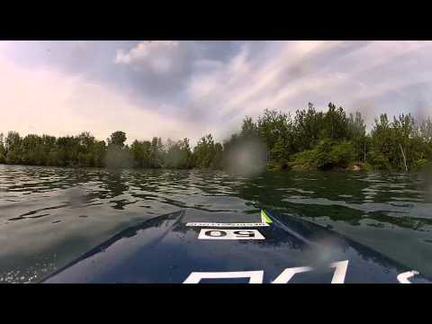

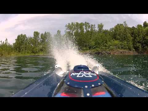

Please come and comment ! eKOS C1 fully upgraded
Looks and sounds really good! What upgrades have you made??
You can have a look at my EKOS build tread for ideas.HPR 115 - Lenher 2240/7, AS26- 150BL EVO ll esc's 92.3mph
One thing I would suggest is to true the Sponsons, it makes a world of difference in the hulls handling.HPR 115 - Lenher 2240/7, AS26- 150BL EVO ll esc's 92.3mph
You block sand the bottom of the Sponsons, to make them flat, and make the inside edge sharp. In my build I explain the process step by step.HPR 115 - Lenher 2240/7, AS26- 150BL EVO ll esc's 92.3mph
