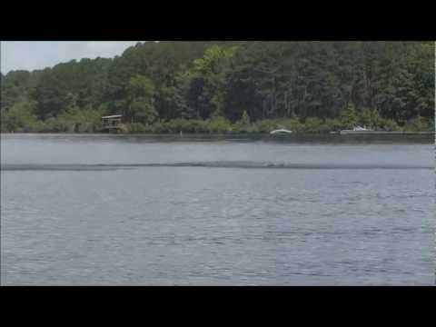

    Fighter Cat Daytona Single 6S
    Video from this morning at the lake. (with crashes and live commentary)
    FC Daytona single
    FC 16S 300A ESC
    FC 3740 1760kV outrunner
    6S1P

      Will it was, Fast.
      And it was, pretty to.
      But those flips had to hurt.

          Thanks Lenny! It was great fun! I won't be running that setup again though. I pushed the COG even further back and had my strut way up just to test the extremities of adjustment. Having the strut up that high added angle as well. It would "wheelie" if I wasn't smooth on the throttle. That's why most of the runs in the vid got a running start. It's also not very forgiving of dumb drivers running over their own wake. The last flip bent the steering rod and broke the servo mount (wood).
