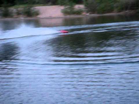

    Setup? Looks very nice, but you need some larger water to run on! It never gets a chance to unwind and stretch its legs.....

      it has a 1000kv leopard a hydra ice 240 two 9000 100c max amp lipos in series and a x450 all temps are good going for x457 and open water sat. will have vid. thanks

          That's way too little a prop for that setup, but considering the small pond was a good idea. What size Leopard? With a 5692 you should be good with an x460 on a big pond where you don't have to do much throttling.
