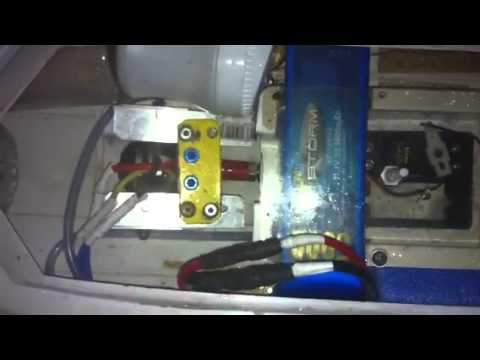

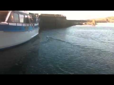

    i finally got a good day to try the brushless viper.
    got around 20 minutes on the first run
    then charged her up again and after 5 mins the bearing seems to have collapsed in the motor
    think it was just too much for the little outrunner!

    has the 2 blade prop on her here, but when you stick a 3 blade on it, it becomes uncontrollable and chine walks like mad!!!

    Runs very nicely considering it wasnt made to go that fast to start with. You may consider trying a 3674 Leopard 1700-2000kv range on 4s...........or 2000-2300kv on 3s
    • haggis
      • Aug 2011
      • 59
      Death to the Overlander 1450kv
      Ive bought the Turnigy 3648 1450kv to replace it
      maybe now is the time to finally install the jet drive and make this my recovery boat
