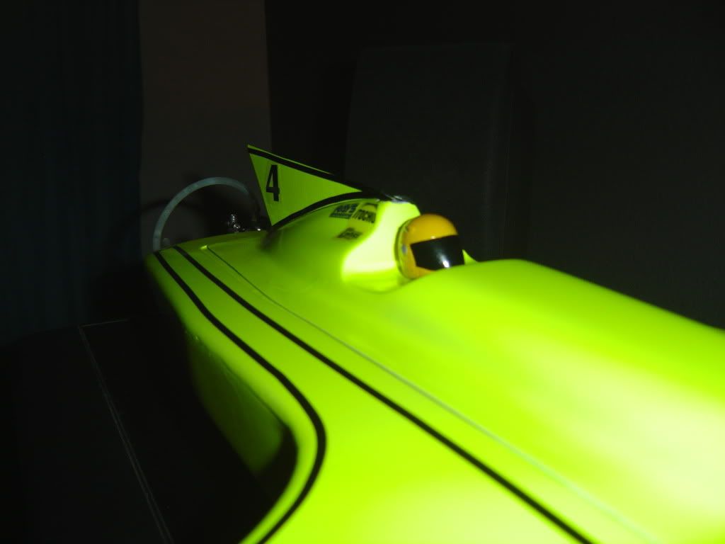

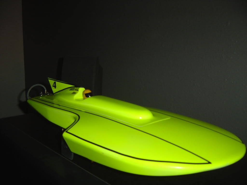

                          I gps'd her yesterday in race trim 49.6 mph, and i didnt go out that far
                          • 6S HYDRO
                            • 1320
                            #58
                            here she is
                            • properchopper
                              • 6968
                              #59
                              Lookin' good ! Should stand out in the pack !
                              • 6S HYDRO
                                • 1320
                                #60
                                thanks Tony
