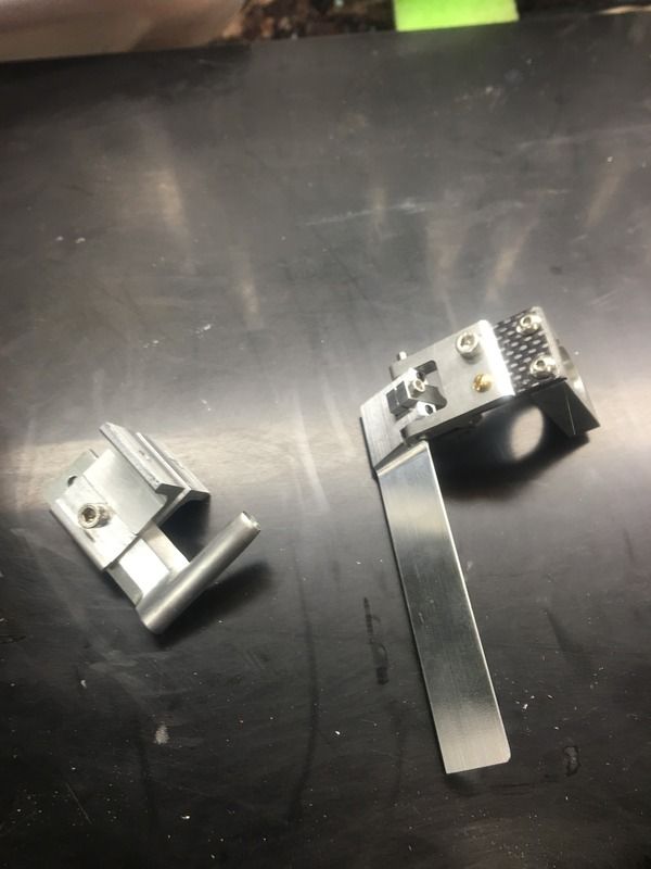

    Well the strut I had just wasn't doing it. So I had to machine a Speedmaster one I had down a lot smaller. Works perfect now and no binding. The other strut was getting super hot and I didn't know it till I bench tested it the other night. I was looking to get around 75ish on 4s with this little thing and I nailed it today on my first run. This is going to a fast and fun little dude once I get it lined out. Had a small prop on it too.

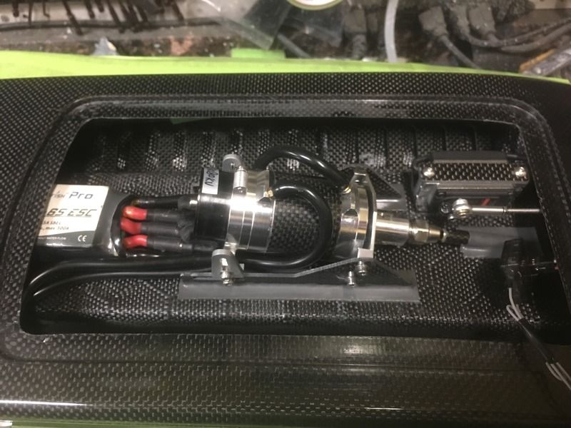

    Tp3650 size motor
    Sf220 esc
    Spektrum servo
    Home made .187 flex
    Mbp collet
    Mono Jeff custom battery trays
    Mbp billet steering rod ends from ose
    Speedmaster rudder and strut machined to fit

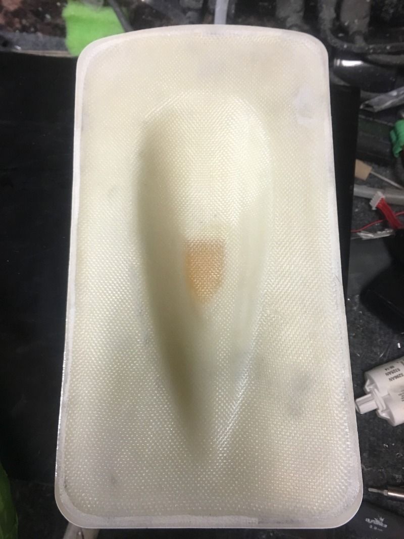

    Heavily reinforced fiberglass hatch

      This is 8 extra layers of glass on this hatch. It should be able to take a hard hit. I did flip it yesterday at about 70 and nothing.
