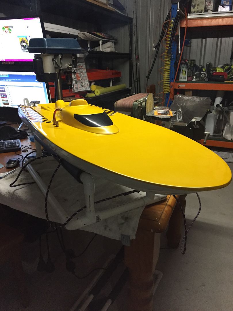

    Well I bought a built boat a 45 inch Thugar EVO capsule with Kevlar carbon fibre inlay
    It runs a TP 5850 600kv with a swordfish 300A pro + ESc on 12s
    Packs are revoelectric 5500mah diamond series
    Have only just got the software up and running for the ESC so a lot to learn how to translate it and know what it means
    I have only run the prop that came with the boat measures 58mm and pitch looks to be 1.4
    So any recommendations on prop size would be great
    I have pulled it down to tidy it up and getting it ready to run in the next week

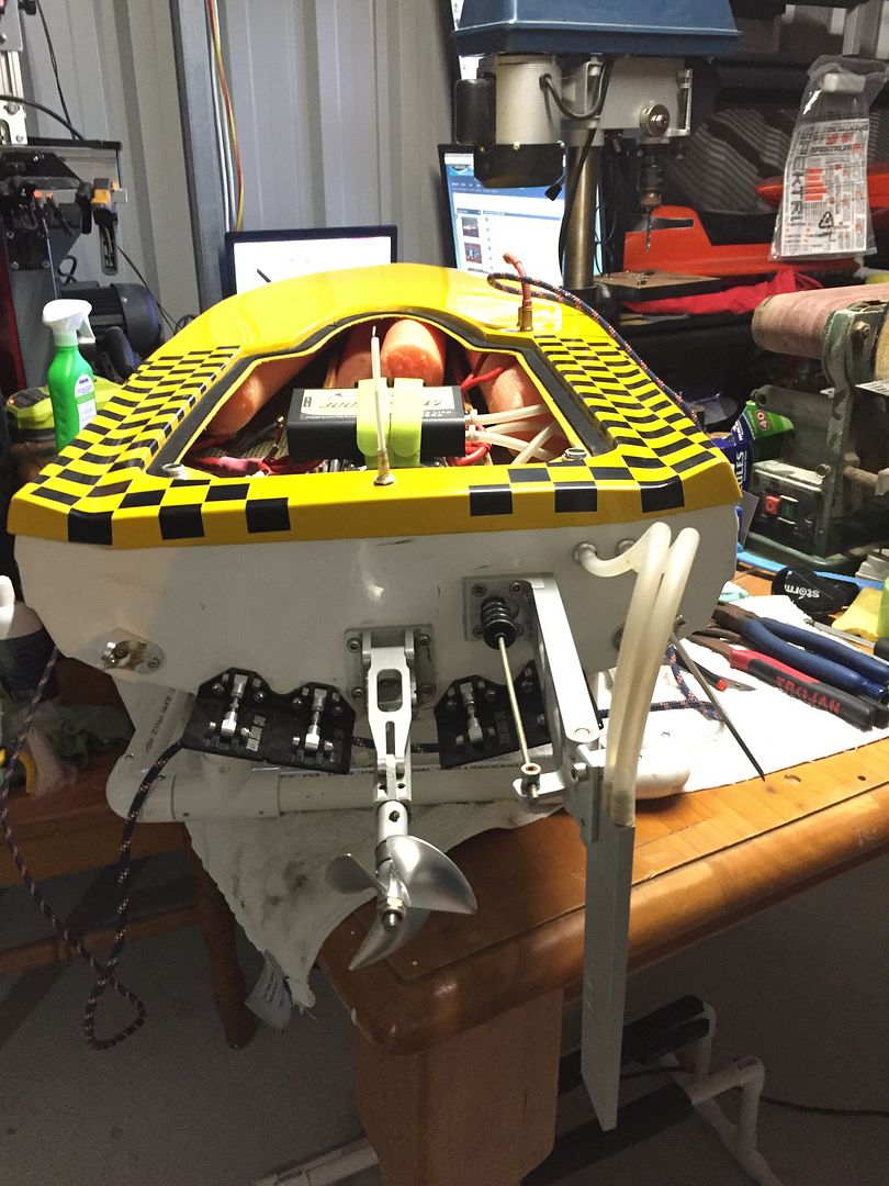

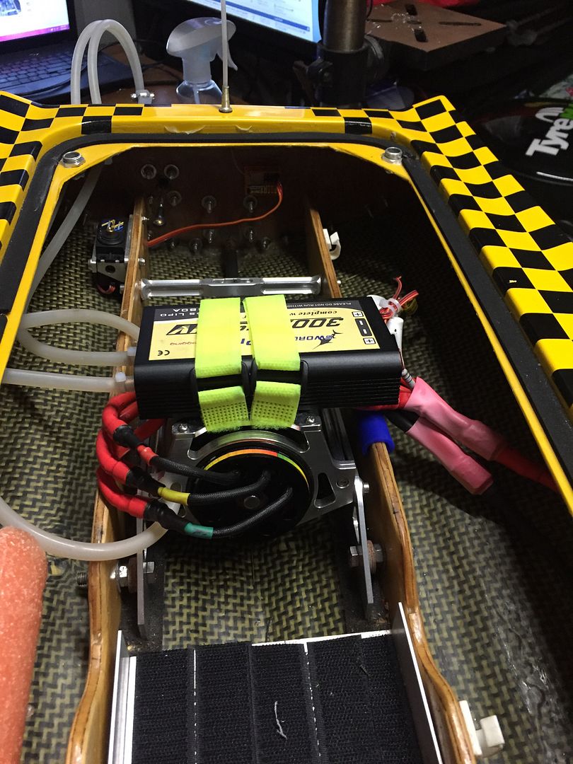

    I have tidied up the connectors as they were very messy
    I have put all 8mm bullets all round, shortened th wires from The ESC to the motor
    The wire from the ESC were soldered very bad, three wires in the one solder joint (including cap bank)wasn't nicely done so I used a electrical cable reducing link 10mm one side and 6mm the other side, much cleaner setup
